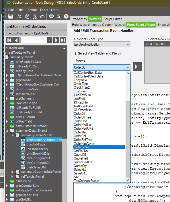

So on the order entry screen I want to add the drawing number associated with the quote that the order line was made from to the order line grid. So I made a BAQ to look up the drawings for the quote and tie them to the order lines. Right now I add a column and run the BAQ on EpiTransaction.NotifyType.Initialize but it turns out that is triggered waaayyyy to many times for what I want to do. Is there a better event for this?

EpiDataView edvPart = this.oTrans.Factory("Part");

It looks like Epicor already has views for Quote created? Is there some way to re-use those to show the quote number for each line and skip the BAQ all together?

Create a New DataView on UI
