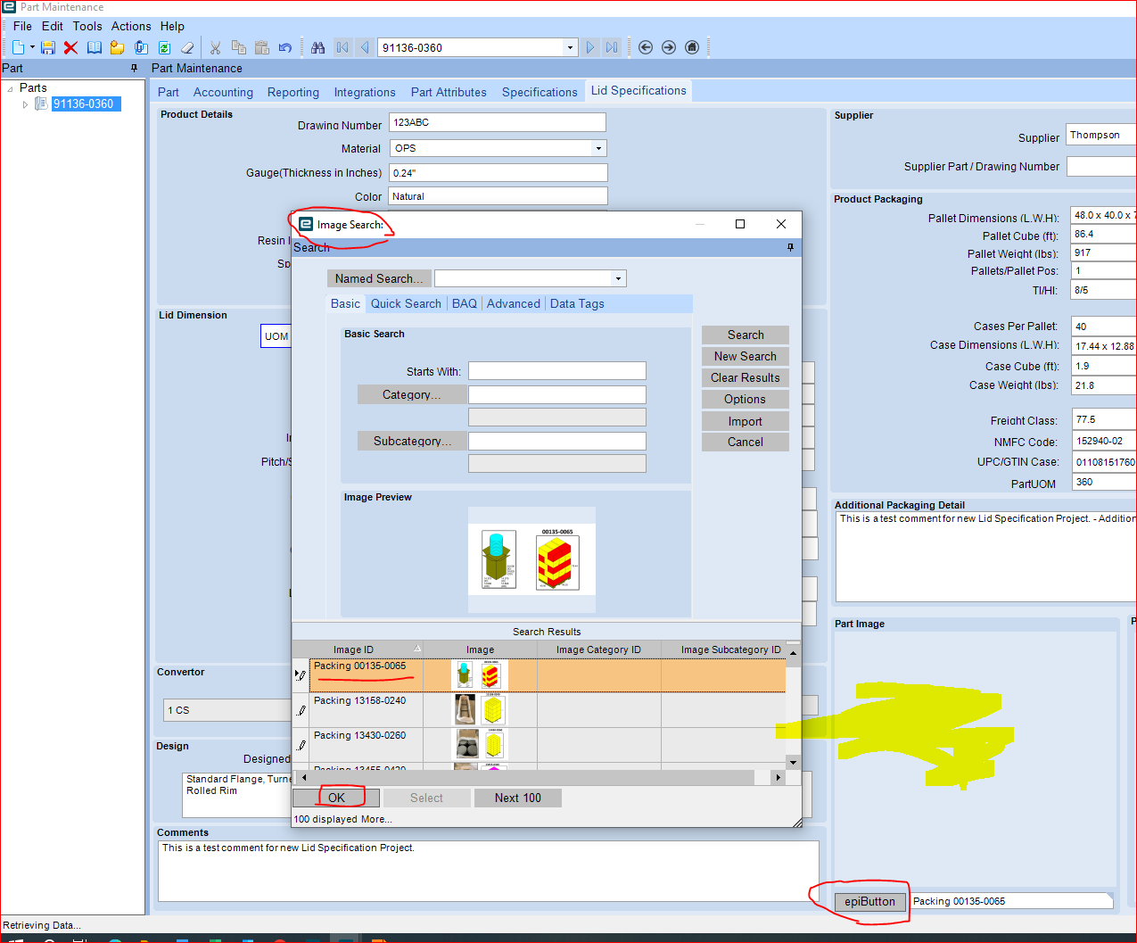

John, I already tried this option. It did not work. After creating the File button through the Customization Toolbox and bound to Part.FileButton, when I click it, the “Image Search” is not opening.
It acts like a idle button.

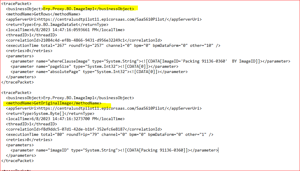

Not surprised. Turn on tracing and see what methods the stock button calls. Add them to your button_click event.
When I did the tracing below is the method I am seeing,

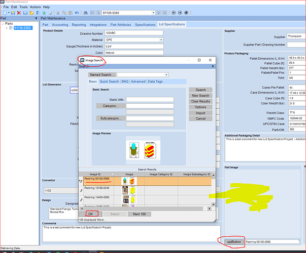

Thank you so much!! the file button is working now, its taking me to the “Image search screen” but when I choose an image and click ok, the it is not displaying the part image. The screenshot is attached below

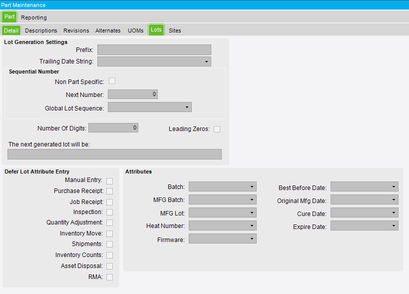

Note that if you’re moving whole groups of controls from one page to another, you can also literally just move them with a couple of lines in InitializeCustomCode(). The group box will pull the child controls along.
Here’s an example where I consolidated the lot generation and attribute tabs into one. I also disabled visibility on the now-empty subtabs.
