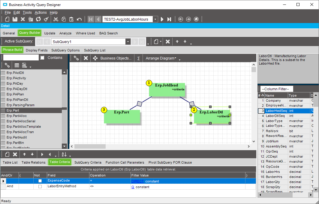

Need help adding Table Criteria
I have been asked to create a BAQ that calculates average labor hours by job and part over a date range.
I need to add something, that in SQL would be Labor.Dtl.ClockOutTime-Labor.Dtl.ClockinTime>0
How can I accomplish this?
Here is my where clause in SQL; I need to know where to add the italicized line to the BAQ

Why not just use LaborDtl.LaborHrs>0
I see what you are trying to get at, but subtracting the times may not be the best option. What if someone starts a job at 11:00pm, them stops the job at 4:00am? I think this would break your BAQ. What about using LaborHrs in the LaborDtl table?
If you REALLY want to do it this way, create a calculated field that = clockout-clockin, then set a subquery criteria on that calculated field.
Well I feel like an idiot, the LaborHrs field, I totally missed. Thanks all.
