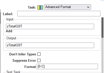

OK, here goes:
This is my advanced format. zTotalGST was obtained in an earlier Aggregate task (summing up the individual line item GSTs which this post was initialy about). I format it and output it back into the same variable

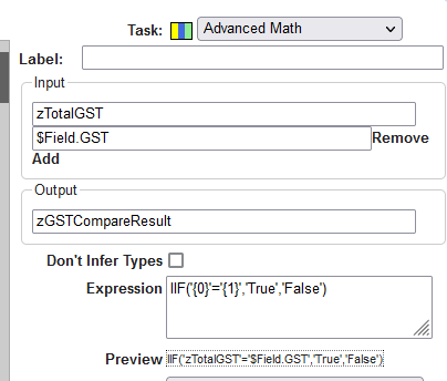

Next up is my advanced math, where I compare zTotalGST to $Field.GST:
Here i used that expression you gave in the last comment. I think I understand it - it’s basically an if statement, right? e.g. if {0} = {1}, then true, else false. The output zGSTCompareResult is a true/false that a branch condition later uses to route the workflow. It is ALWAYS returning False, even though the two values I’m comparing are now the same

By the way, I did a workflow recording, and here’s a snippet of the advanced math part:
There’s two other values in that input, and I have no clue where they came from! That might be the problem lol
Lol That may certainly be a portion of the issue, but it does also look like the “zTotalGST” value is “$24.50” and not “24.50” which is the original issue. The Replace Text task should be able to remove that “$” character so that it can properly compare with the GST field, once the others are removed. If you could, providing more of the recording for all of these tasks will likely give us more to evaluate as to what the issue(s) may be.
