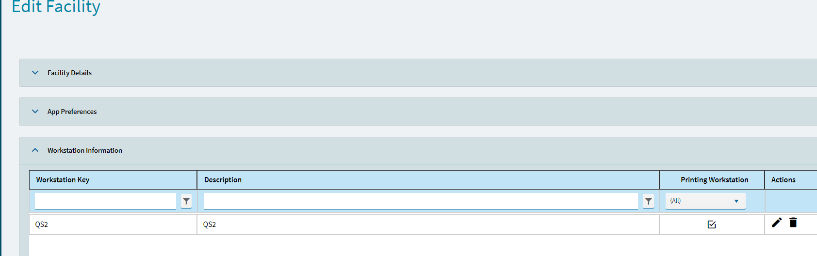

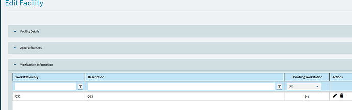

  • Create a workstation on Epicor (e.g. QS2)
  • Set up the facility and define the workstation

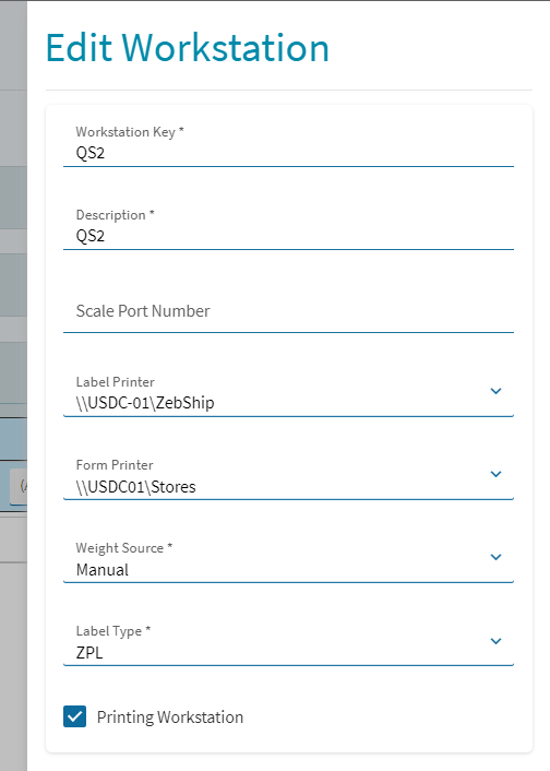

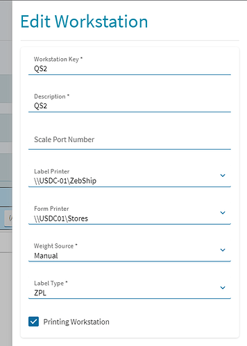

  • In the workstation define your printers and label type

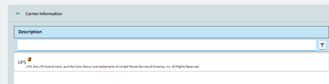

  • Setup the carrier information in the workstation

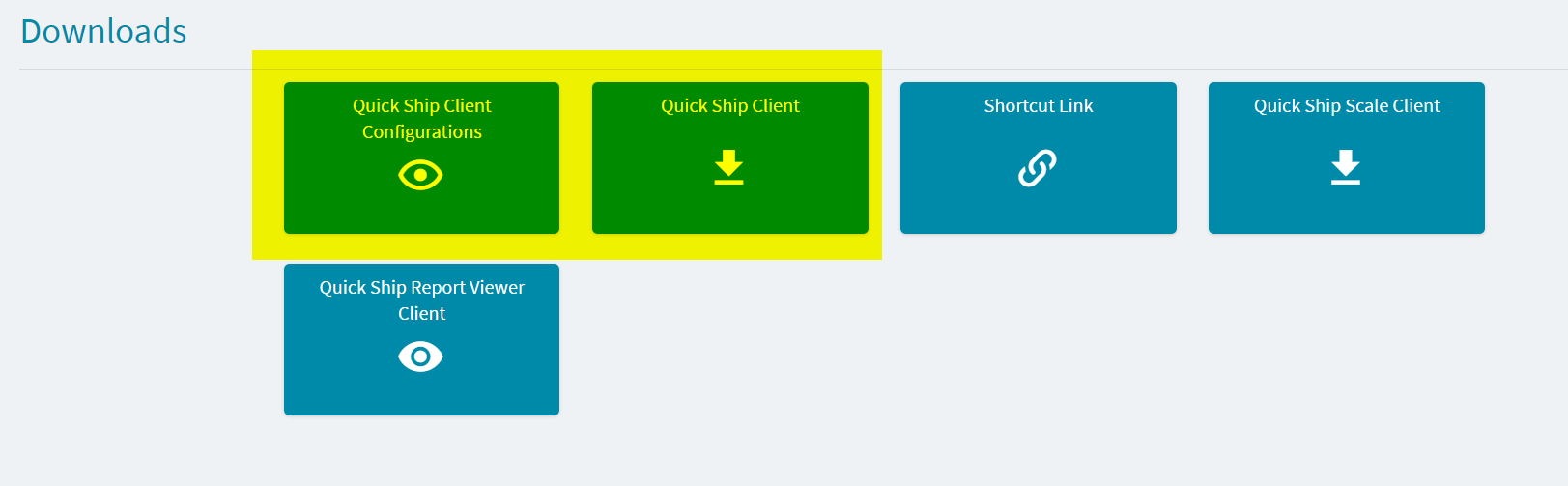

  • To set up the workstation you need to download the following from QuickShip - Setup Downloads on the machine that will be your workstation

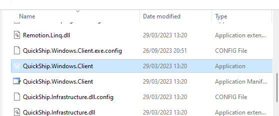

  • Unzip the client into a directory on the workstation PC
  • Create a shortcut to the following file in the directory with the unzipped files
  • Double click on the shortcut and the client is now running

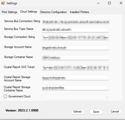

  • Right click on the icon and select settings
  • Select the ‘Upload’ button
  • Select the ‘.qsx’ file that you downloaded from QS

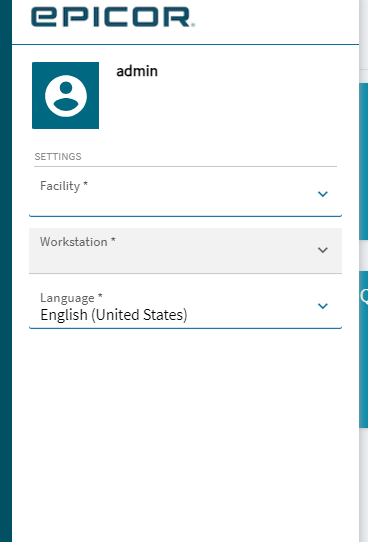

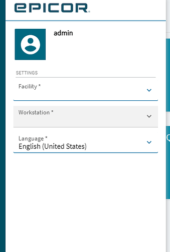

  • Log onto Quickship on the workstation PC
  • Set the workstation

If your using UPS, the the goal initially should be to print test labels and get a dummy tracking number returned.

I am working on installing the Cloud Print Monitor on our Printserver instaed of where I had it installed, so it can “See” all printers there.
I do have the Workstation in Kinetic Setup and I guess I need to just put the physical path to the printer in the Quick Ship configuration, as I figured the Drop-Down would show the printers but it doesn’t. I really appreciate your help on this everyone!
