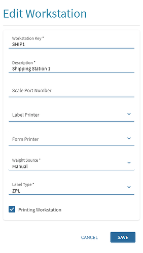

I see within Quick Ship that when I edit the Workstation, it has no Label Printer or Form Printer defined and the drop-down shows nothing.
Is this the printer from within the Workstation Setup in Kinetic that uses the Edge Agent? Will it populate these fields?

I installed the Quick Ship Cloud Print Monitor on a server on the network.
Uploaded the Config file and added the Shipping Station ID.
The default printer is CutePDF but not sure if that is supposed to be an actual Printer?
When I look at the Workstation in Quick Ship, I still see no Label Printer or Forms Printer in the Drop-Down.
How do I associate a printer with that station so it prints to the correct printer or any printer for that matte.
George I think you need to set up the workstation in Epicor and tie printers to the workstation.
THEN you need to go into quick ship and look at the workstation there and select the printers.
I think that’s the order.
Have you done that?
I believe you also have to install the printers on the server running QS. Then when you edit the workstation in QS you can select the appropriate printer.
The thing is they are cloud. But yeah you’re right @KPreda that’s what we do on prem.
