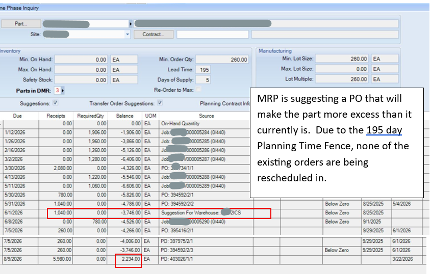

I need help please. I’m trying to figure out why Epicor is suggesting a PO in the middle of where we are negative, when none of it is actually needed. Placing this PO would create excess - AND the PO suggestion is still months after we go negative. I’m new to the company and IT can’t figure it out and said it’s possibly a bug.
The Planning time fence & lead time is incredibly long (working on that). Any insight of what to look for is appreciated.

Thanks, my next question is if I go negative in January, why is it suggesting a PO in June?
I would have to look at your details to figure that out. That screen shot isn’t enough information to be sure. I would bet it’s a combination of change suggestions and new suggestions that’s messing with what you are showing. I’ve seen stuff like this many times, and I’ve never seen it be a bug in MRP. It’s always some setting that’s causing it to do that.

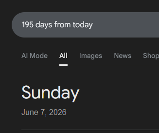

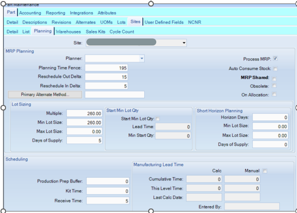

Ah, probably has to do with that 195 day planning fence.
I’m curious about this. Are the dates and qty’s locked on the PO’s due on 7/5 and 8/9?
The new suggestion due in June makes sense based on your lead time and time fence. I’m wondering why MRP didn’t make a change suggestion to expedite and increase the PO’s that are outside of the planning time fence.
