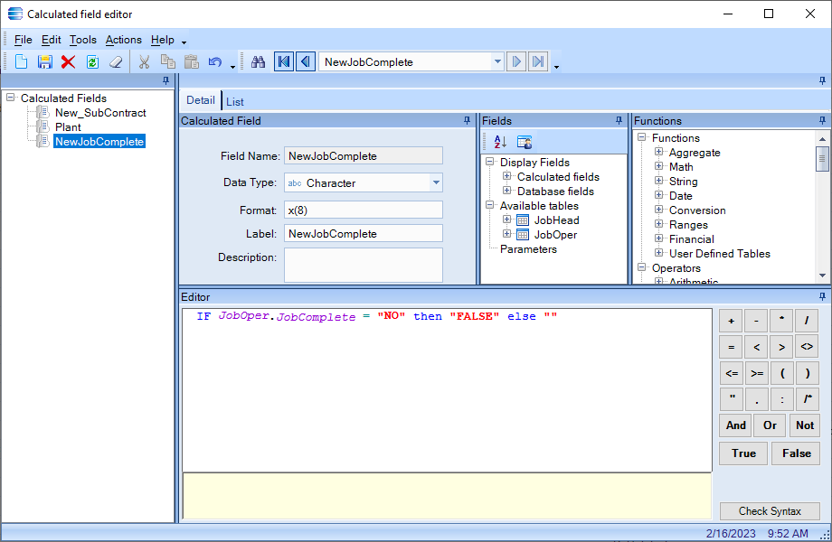

I need help with a IF Statement I need to change the Yes or No field to read TRUE or FALSE instead. (see my code below)
The check syntax says it is good but fails when tested. (See Below)
Thanks in Advance.
Miguel

Try this
(case when x then y else z end)
Or if you want to use if, you have to use the SQL version. The “Yes” or “No” is actually stored as a 1 or 0 in the field.
iif(JobOper.JobComplete=1,"True", "False")
Hello Nate,
I am on E9 (Progress Database) and I tried your example with the same error. If you have any suggestions I would appreciate it.
Thank you.
Miguel
The IIF() function Nate suggests is only available in MS SQL Server 2012 and newer, but it’s really just syntactical sugar for the standard case/when statement. Jason’s on the right track.
You want case when JobOper.JobComplete = 1 then 'TRUE' else 'FALSE' end
