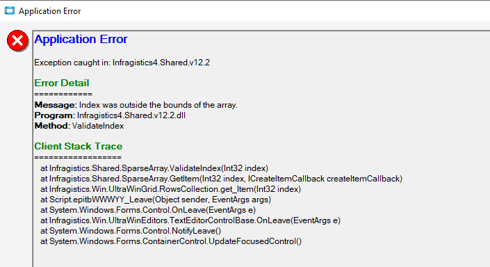

I am in need of your experience, expertise, and guidance once again. I have been racking my brain trying to figure out what is wrong with my code that is causing it to produce this Application Error.
Maybe one of you can assist me in finding the issue in my script.

Thank you for the suggestion John Kane, I really appreciate it!! I just tested that, unfortunately that did not resolve the issue. Error code still appears. :confused:
Does the grid you are updating have 5 rows in it and does each row have a cell in it? If you have a supported version of Visual Studio, you can open the form and check the box to Debug in Visual Studio (to set break points and look at values). If you don’t, try commenting out the lines from the bottom up to determine where the error is happening
I figured it out. I have a Private Void that is checking the lines in the grid, which it is set to check 7 lines. In the label private void, it only has 4 lines so it is throwing a warning that is is out of array. It can’t check 7 when there are only four.
