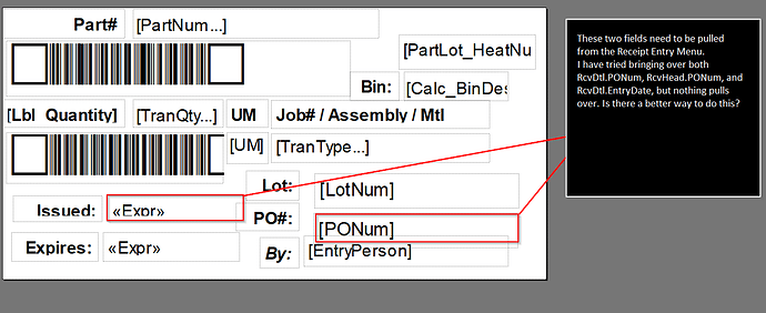

Has anyone been able to do this? It seems when material is issued, the PONumber gets lost and changed to “0” in the Part Trans. History (which is originally where this form tries to pull from “PartTran”).

Well here’s the issue, on the default report style, it would just pull “0” for our PO number. It looks like when we are issuing material, the PO number gets lost and just gets set at 0…?
Refer to my image, it seems very odd.

I mentioned Receipt Entry earlier because we wanted to pull the PO number and Entry date from there, BECAUSE we were having this issue of the PO coming up as “0”, if that makes sense.

The RDD for the Inv Movement Report already has the parttran table in it so it it can’t be done like I was thinking.
You might need to add a UD column to the table that holds the lot info, and add the PO num to that when it is received. Then use that value in the Inv Movement Report’s RDD & RDL

@keatonskills This is how I handle this. I add the PO, Vendor ID and Packslip to PartLot in the description and in UD fields. Make is very easy for anyone to know where the material came from especially when doing a DMR and I don’t have to read PartTran. It looks like from your label you already have the PartLot table in the RDD. If you decide to go this route I have queries to build DMT files for backfilling data on PartLot as I just added expiration date to this process last month.
Sorry for the late reply everyone, THIS is what we are doing as well! @Michael_Ramsey@ckrusen
Basically when something is Received in Receipt Entry, a window will pop up with 4 UD fields asking for Heat, Exp Date, PO and PO Date,(We set these as tracked in Part Maintenance > Lots > Attributes) which gets populated in PartLot, which the label ends up pulling from. So it ends up working!
Is this similar to what you do Greg?
@keatonskills Same basic process. We don’t use the formal quality attributes popup, I added UDs to the receiving screen that are saved in RcvDtl and then update PartLot if the part is lot tracked.
