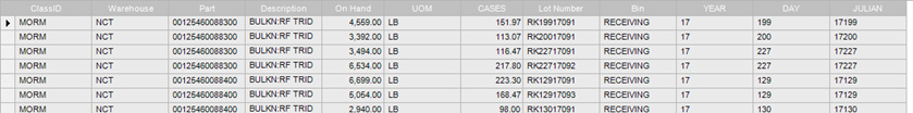

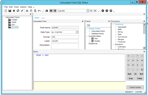

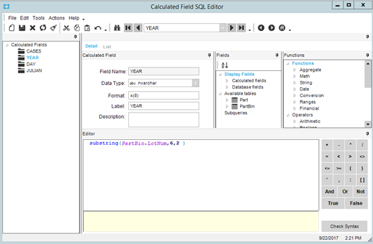

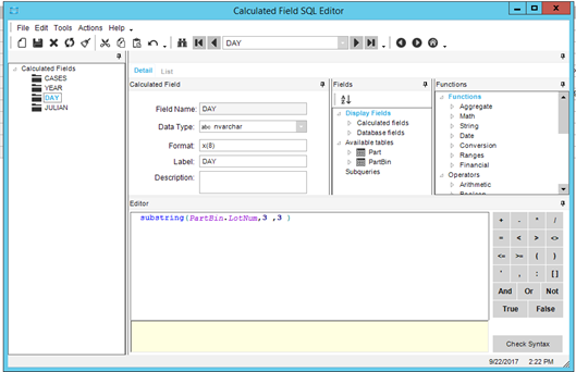

I am getting a syntax error when attempting the first function. I have added screen shots below to help with our discussion and to confirm that I have the base BAQ created correctly. Currently my work around is to dump this report into an Excel template. Please review at your leisure.

Here is the BAQ report:
Here are the three calculated fields:
