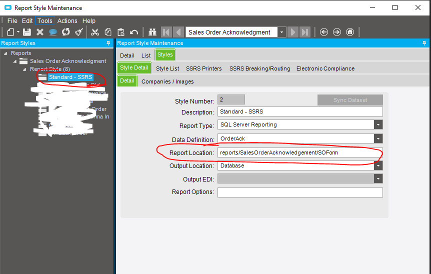

The report style menu is where you would go to look up the OrderAck report and see where the report style points to. In other words, you go here to see where the report location is.
NEVER modify the standard reports. Always make a copy of it using actions>Copy report style.
