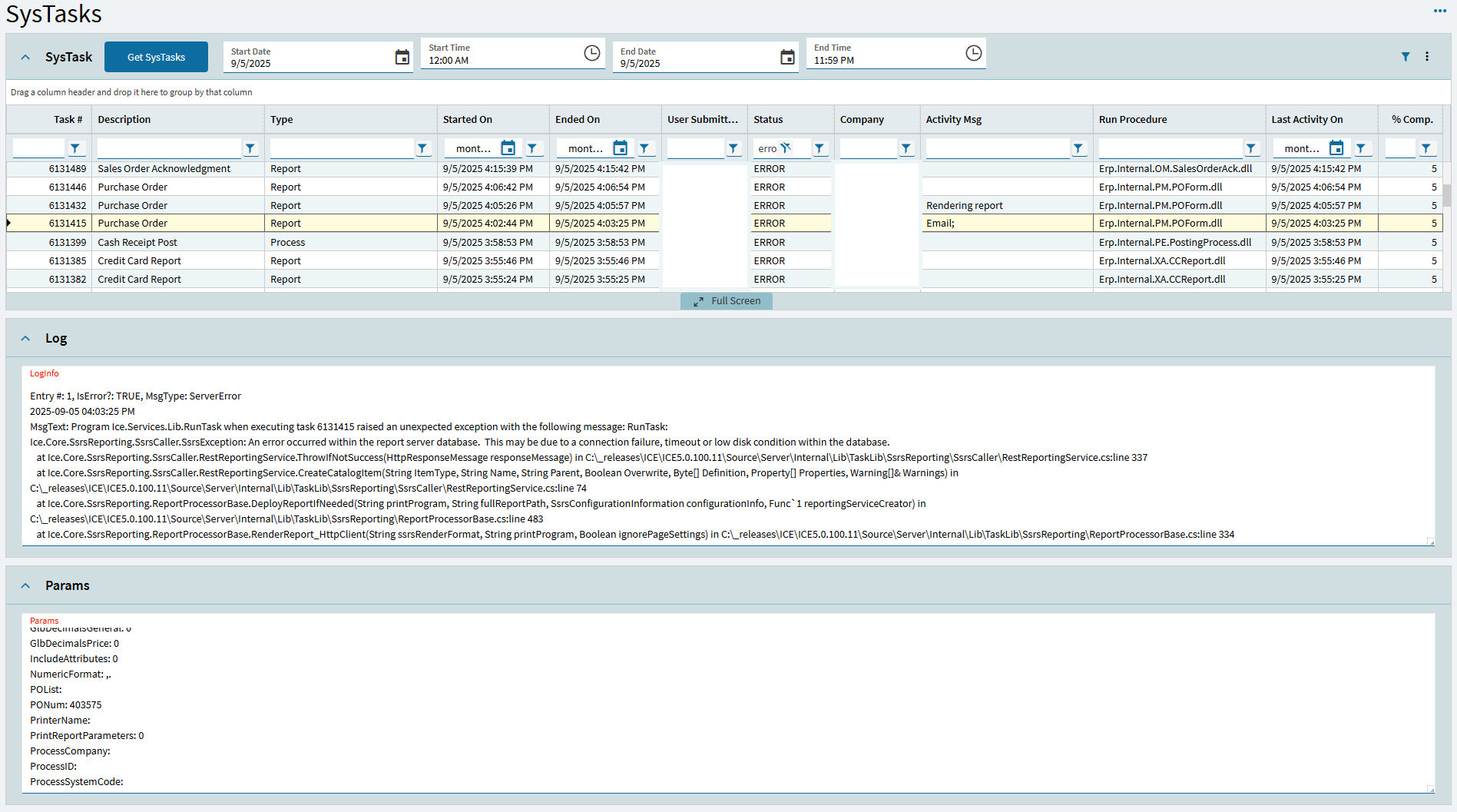

I made a SysTasks dashboard to help diagnose issues like this, it’s posted here at epiusers. I wanted to proactively find send failures, so that they could be re-sent.
In this screenshot, a Purchase Order was printed with routing enabled, and failed report generation with an SSRS error. User would not have received any indication of failure unless they checked system monitor (they wouldn’t) - so they’d assume material was on order, and it wasn’t, that’d be bad!
I look for:
SysTaskParam:
SSRSEnableRouting = true
ReportID = ARForm
CurGroup = xxxxxxx
You can use CurGroup to join against InvoiceHed and get all the invoices that were posted in that group, to get the invoice numbers.
Then you can line that up with the subject line from emaillog (we put the invoice # in the subject)
Any failures jump right out - a systask with ssrs routing enabled and no entry in the email log is a fail.
