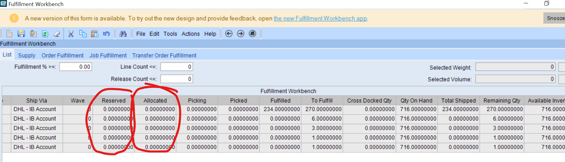

We dont “use” Fulfillment Workbench either… but we have it. We don’t reserve or allocate parts, but we’ve seen parts get mysteriously allocated before.
I’m just suggesting you look up the problem part in Fulfillment Workbench and see if there are any reservations/ allocations against it.
In Fulfillment Workbench, this Part has no reservations/allocations.

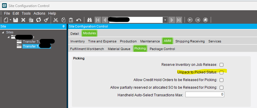

This might be related to site configuration if you’re multi-site. There’s a tickbox (see below) that dictates what happens to stock when a shipment is deleted, whether it remains as picked, or returns it to the location it was picked from.
There’s a setting in company or site maint that says what do when a part is removed from a pack slip. Put it into picking, or back into inventory.
edit: @barryd sniped the answer on me!

Well I will be, it is turned on. But we are single site.
