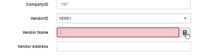

I did switch it around, sorry. But it is still not working.
This is the Formula for FT_Vendor_Name:
IF (FT_VendorID=“VEND1”,“VENDOR ONE”,
IF (FT_VendorID=“VEND2”,“VENDOR TWO”,
IF (FT_VendorID=“VEND3”,“VENDOR THREE”,
IF (FT_VendorID=“VEND4”,“VENDOR FOUR”,“”))))
I am using the “Preview” and selecting VEND1.
FT_VENDOR_NAME stays blank. I click the calculator and nothing happens. I hover and I see the same scope variable error.
The Dependent Items switches automatically as shown in the screenshot.
