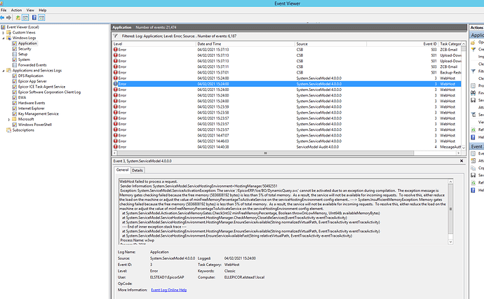

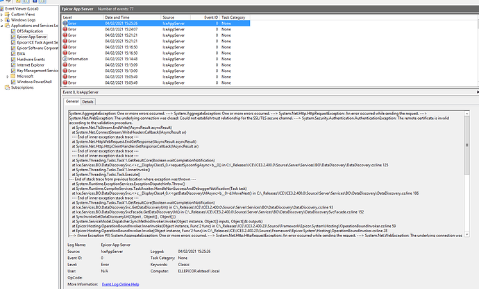

Go to the server machine, open Event viewer and look into the errors in Application and Epicor App Server folders

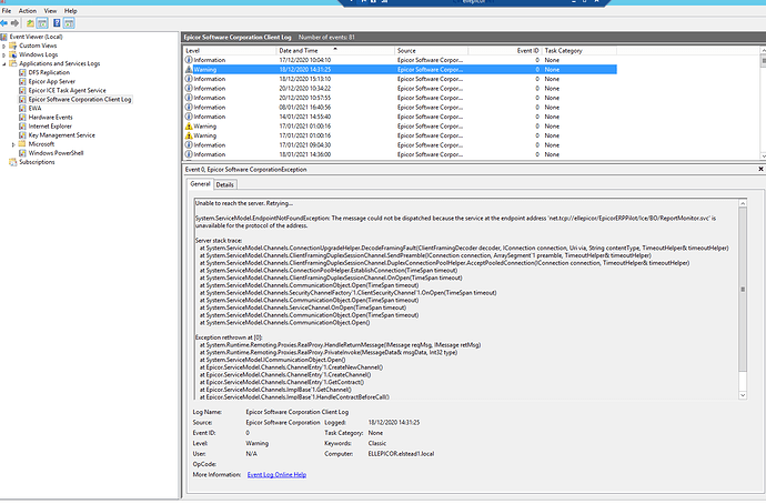

No, this is from client, check on server.
that is for Data Discovery cert, I don’t think it is connected to ERP login.
What are other errors, and what is in Application log
it looks like client level errors as its in the client log but it happens twice a day we have 40/50 on epicor
Yes, it is client, and you need to go to server log. Wxpand Windows Logs there and open Application log. There may be additional information
Good, this is the reason. You need to change your web.config to remove that limit:
