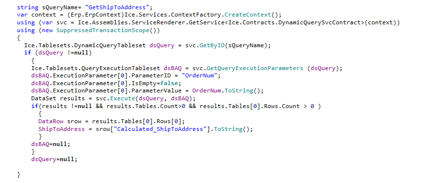

and you suppress transaction with something like this:
           using (new SuppressedTransactionScope())
                using (var dataContext =  code_to_create_context)) {
                  // do something with dataContext

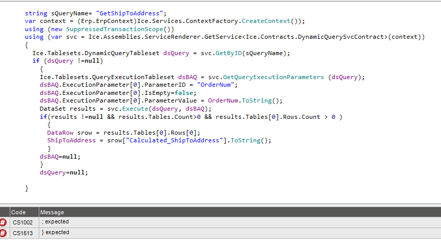

I don’t know what I’m doing wrong.
You have an extra “)” at the end of the CreateContext()); line (2)
ugh, thank you. That allows it to compile but still get the same error when using the updateable dashboard.
you have it in wrong order. You need to add line with Suppress before you create context.
You added it after context creation.
Switch 2nd and 3rd line (and add using for context as a good citizen
Still getting the same error :frowning:
