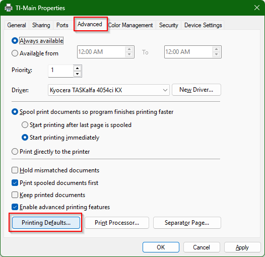

As long as you set tray and other items within the printer Advanced > Printing Defaults area they should stay honored properly.
We have the settings configured in that area, unfortunately, Kinetic still only uses the first tray.

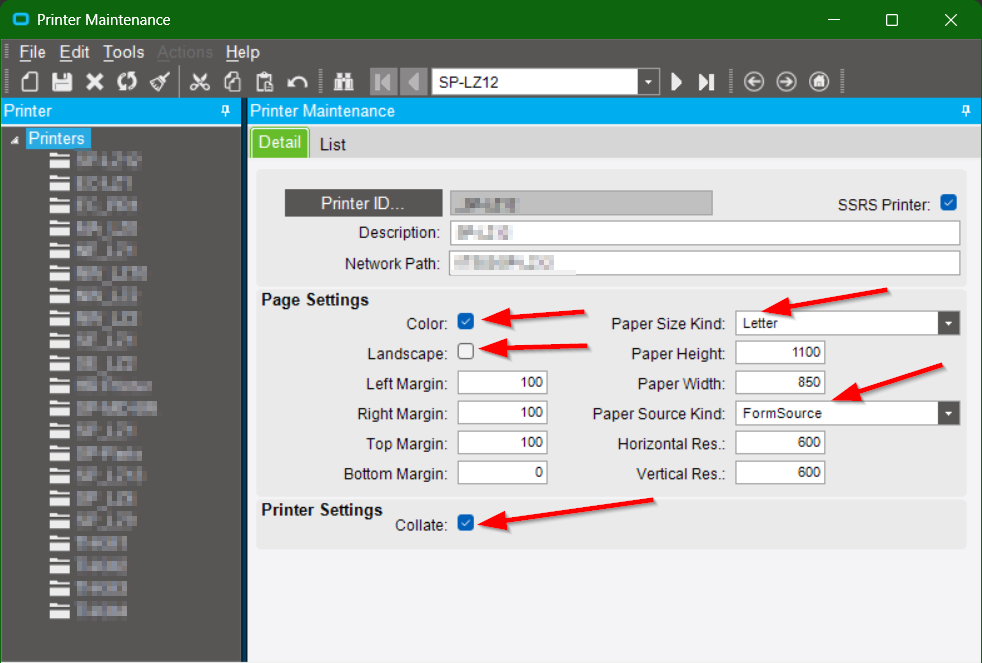

And you verified the settings match on the Epicor side as well?
These should match the settings if you add printers to Epicor.
The settings match, the only part that I can’t match up is the Paper Source Kind because it doesn’t let me put a number for the tray.
