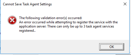

I’m trying to install 10.2.600.7 on a new server for testing purposes (using an upgraded DB from the old server), and I’m having an issue adding the task agent. I’m getting an error saying “There can only be up to 3 task agent services registered…” when I try to add the first task agent to the new app server.
I’ve tried reinstalling the task agent (it’s version 3.2.600.0), and re-registering the app server.
Any ideas?

The logic in the server is looking to the [Ice].[ExtServiceRegistration] table to count the number of registered Task Agents. That is where it is finding too many.

Good call, there are 3 records on that table for our old app servers. How might I fix it?

Thanks much for your time @MikeGross @pferrington , deleting the records from that table cleared the error in this testing environment. I’ve opened a case with support for a better/more permanent/Epicertified solution for our production environment down the line.
