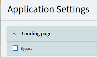

2025.2 brought back the landing page for Part, and they have introduced a per user / per app setting to bypass the landing page, it is in the overflow > settings, i havent tested .4 however earlier pre releases had a bug where it would remove the landing page but not move you to the main page.
With the events that are part of the base application from at least 2025.1 you can create an event after Initialize Trans view to run a base event called ‘SetBypassLandingPage’ this then bypasses the landing page.

Confirmed working in patch 4.
