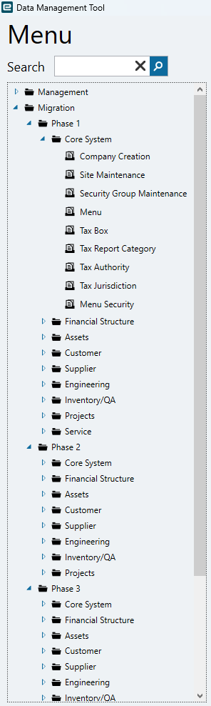

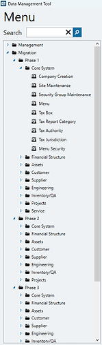

At least for the order of data loading, the Data Management Tool (DMT) has a handy guide:

Ah yes, this could be a handy reference.
