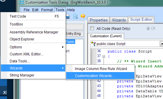

When you’re in Customization Mode, go to Tools menu, Wizards, Customization Wizards.
Then choose “Business Logic Method Call” and launch the wizard. You want the adapter for whichever UD table you’re using (if it’s UD01, choose the UD01Adapter, etc). Once you have an adapter, you’ll get a list of the methods available. Fetching data is usually a “Get” method. When you finish the wizard, it will insert code into the Script Editor as a method you can modify, then call from the Customer_AfterFieldChange event.
