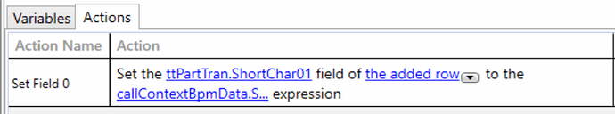

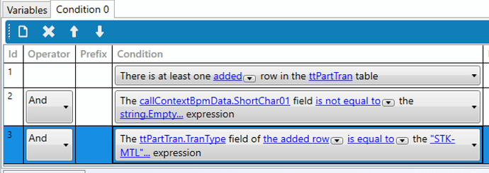

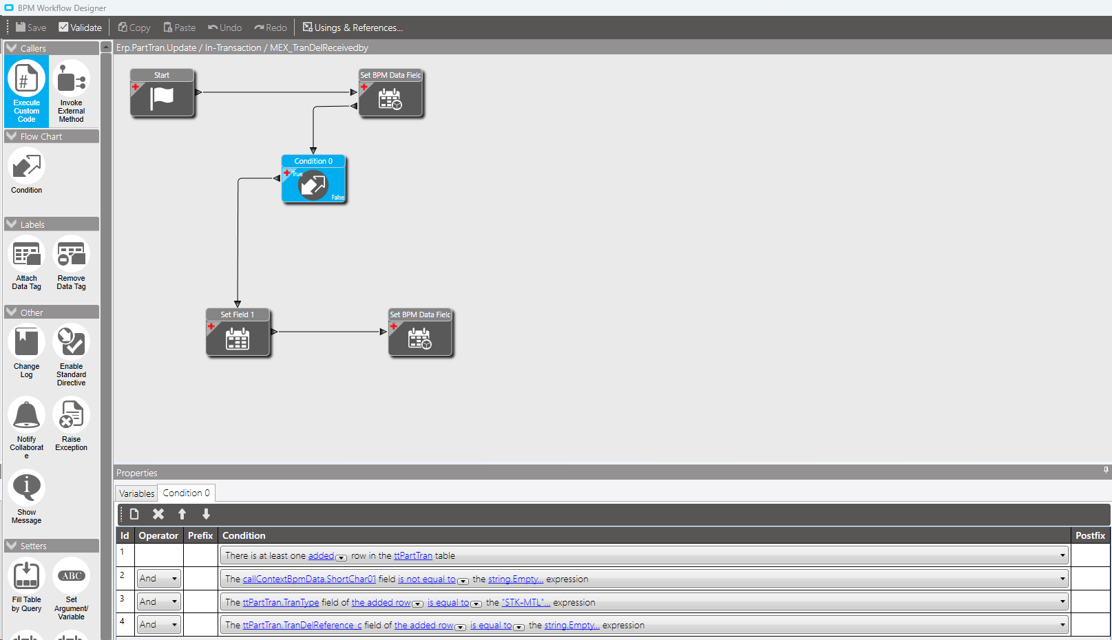

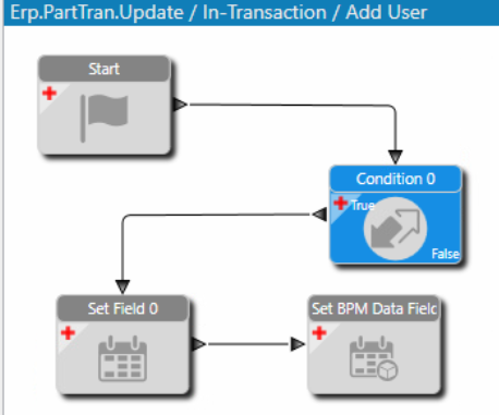

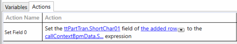

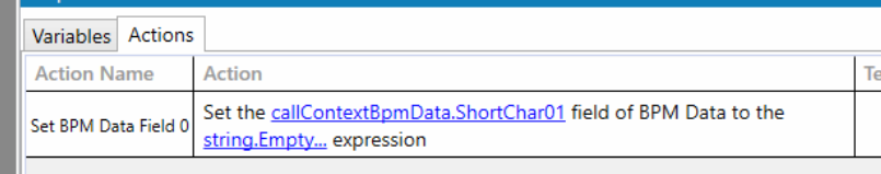

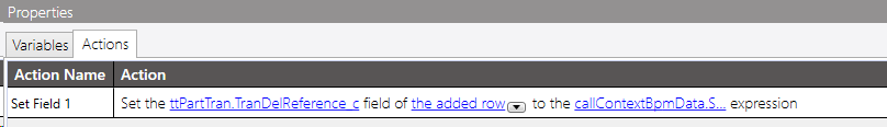

@MEMFabila I would bind your textbox to a field like CallContextBpmData.ShortChar01 and then on the add of PartTran slide it into your UD and clear the BpmData field.
This should also work in the new UX when converted.

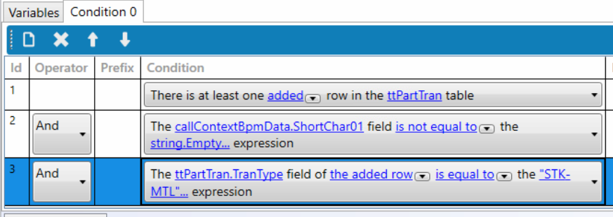

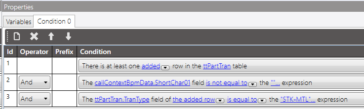

The added assumption was wrong. PartTran is already added and is modified in the data directive. The below has been tested and I used another UD field, so you just need to remove the hardcoding of SC01 and change my UD to yours.
This is from my serverlog.
<Trigger table=“PartTran” type=“Modified” pk=“PartTran<~>a129487b-fc97-4a0f-a5e3-a3abebda30f7”
