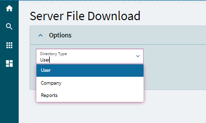

For quite awhile, Epicor has provided a program to download files from the EpicorData folder:
It restricts the User folder to the logged in user.

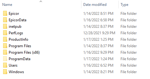

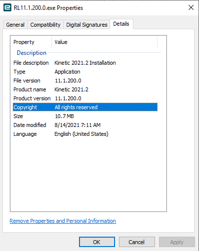

I just did an K2021.2 fresh install and it created the EpicorData folder. :man_shrugging:
This one Mark?
Yep.
What Server OS?
Windows Server 2019
Son of a … :zipper_mouth_face:
It’s standalone and not on a domain for what that is worth… I have two Hyper-V VMs (App/DB) running under Win10.
Mine’s added to the domain on two HV VMs (App/DB) on 2016 servers. Doesn’t make sense.

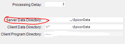

@Mark_Wonsil , were you able to specify the drive that the Epicor Data folder was on or did it put it on C?
I keep trying to figure out how to adjust this… I want it on D: but it’s on C:…
Is it in the webconfig?
That’s the truth about the Good ole days! Ben was the best!
It’s on the system agent… I knew it to be somewhere familiar. I always forget this spot.
Also, if you have two app servers this field on the system agent can be different… I wonder where this value is stored if not in the database.
I ended up manually creating it on D:, created the permissions, and made it shared to use in the sys agent path.
