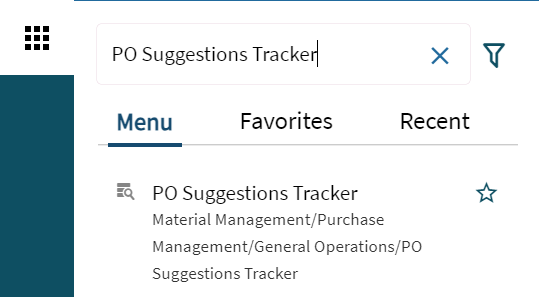

I just created a new Kinetic App/Dashboard using the wizard in Application Studio. It is super basic. Just displaying a grid from a BAQ.

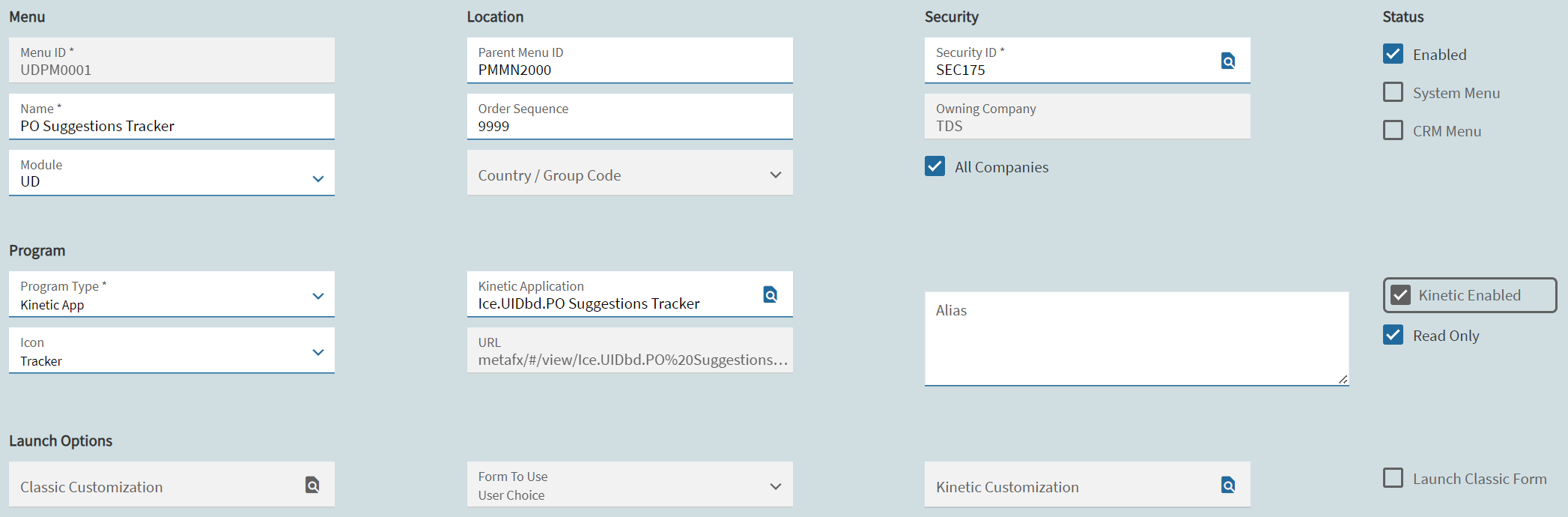

I created a menu item for the app, with access to all users by default.
Menu Maintenance
Menu Security

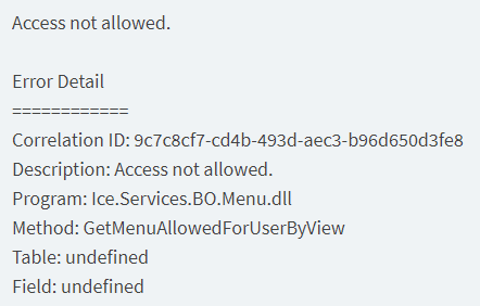

When I attempt to launch it, I get an error ‘Access Not Allowed’.
Any idea what I’m missing?
Did you allow access in the User Groups or Users panel card? Are you security manager?
I’m a security manager, and the default access is Allow. I re-used the same Menu Security ID as the ‘General Operations’ menu item (folder). All of our users have access to this menu item.
I can see the App’s menu item in the main menu, but I get the error when I try to run it.

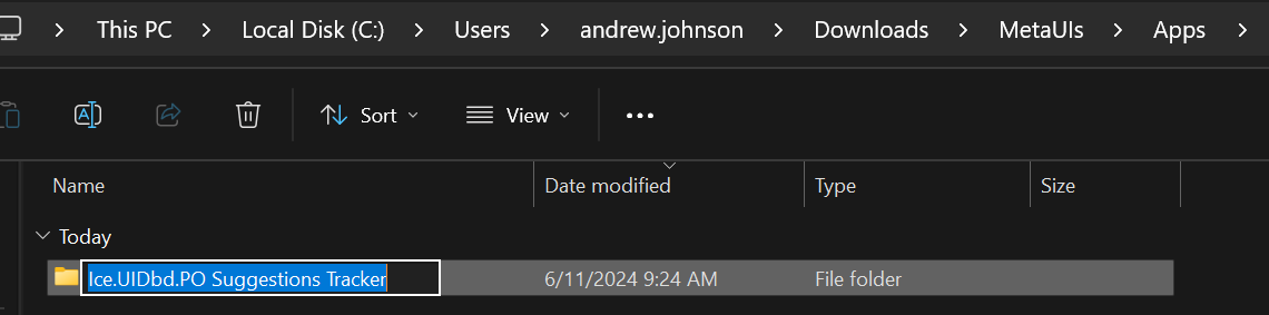

Wild guess, but try to remove the spaces from your application ID. You will have to export / import under a new name.
I can’t say I’ve ever seen an app with spaces in the name.

You could also change the security to SEC000 (I think is a default, wide-open security) and see if it lets you through.

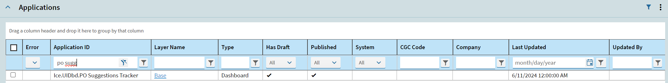

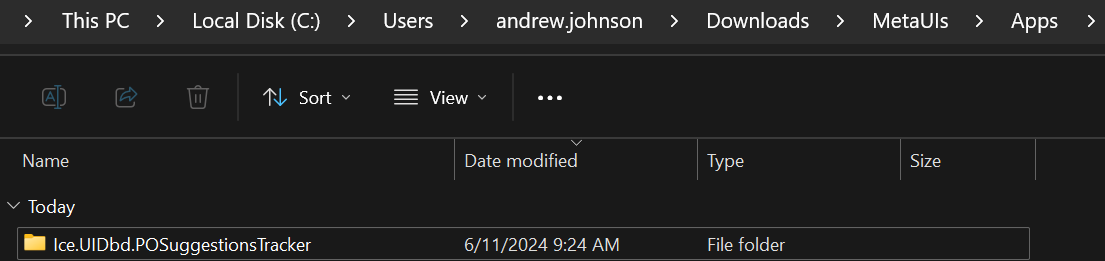

So I exported the app/layer, changed the app name in the folder structure, and tried to Import the updated zip file. No errors, but the app/layer doesn’t appear in the Application Studio list.
So I changed the name back, Imported again, still doesn’t show up in the list.

I decided to just start over. I realized that the first field in the App Creation Wizard is for the actual name/ID of the app, not a descriptive name. So I named it accordingly, with no spaces. It is now working as expected.

OOO… i got it… I think… Instead of zipping the MetaUI folder, I zipped and uploaded the “Apps” folder… and it now appears.
