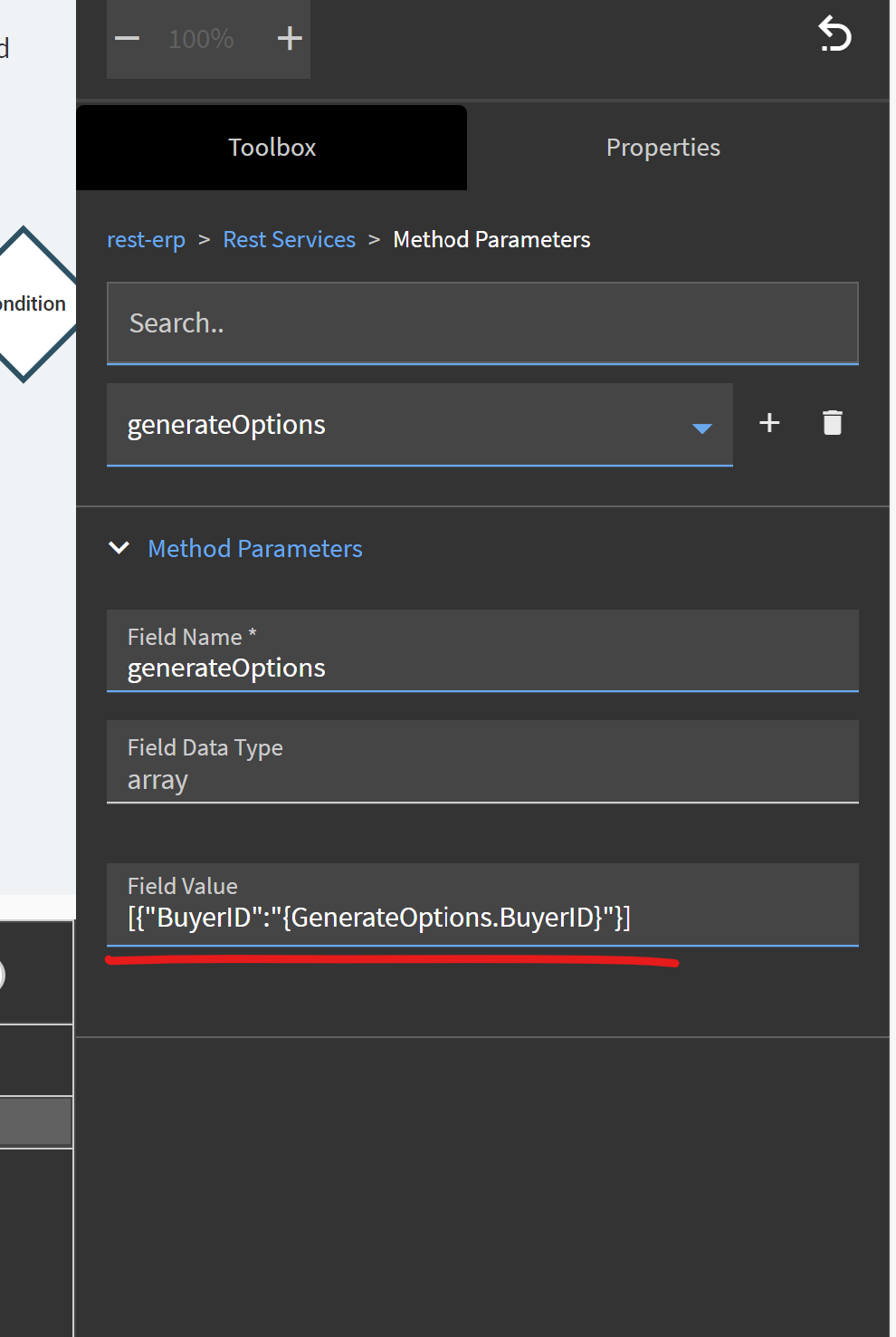

Now, I am struggling to figure out how to create an array for the REST-ERP widget. I tried as shown in the image:
I also tried using comma-separated values like BuyerID="{GenerateOptions.BuyerID}", but nothing seems to be working.

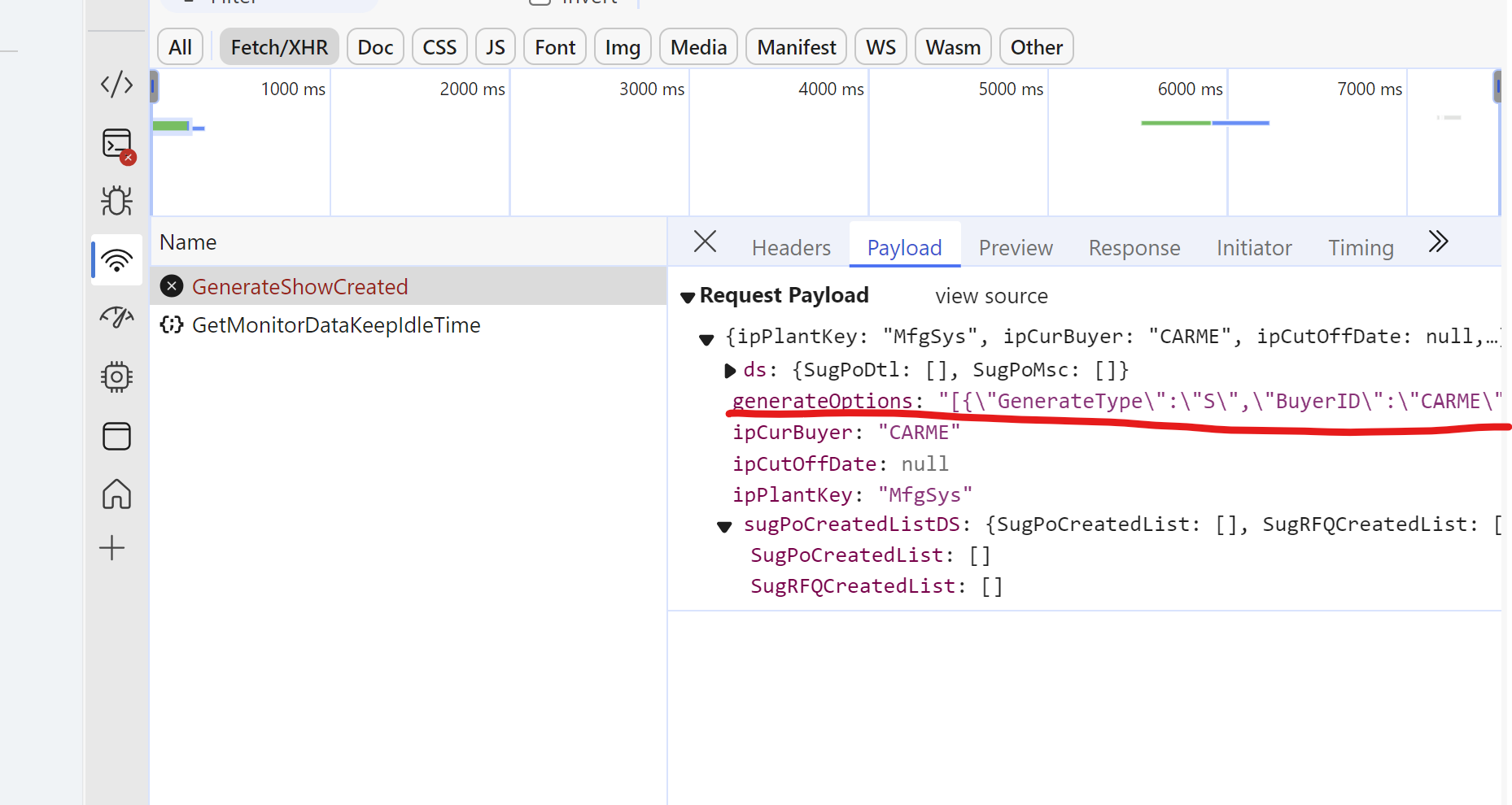

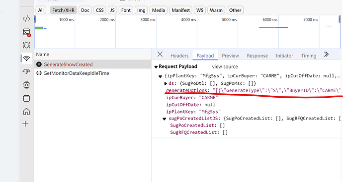

After trying to create an array from the data, I noticed that each time the parameter is passed as a string:

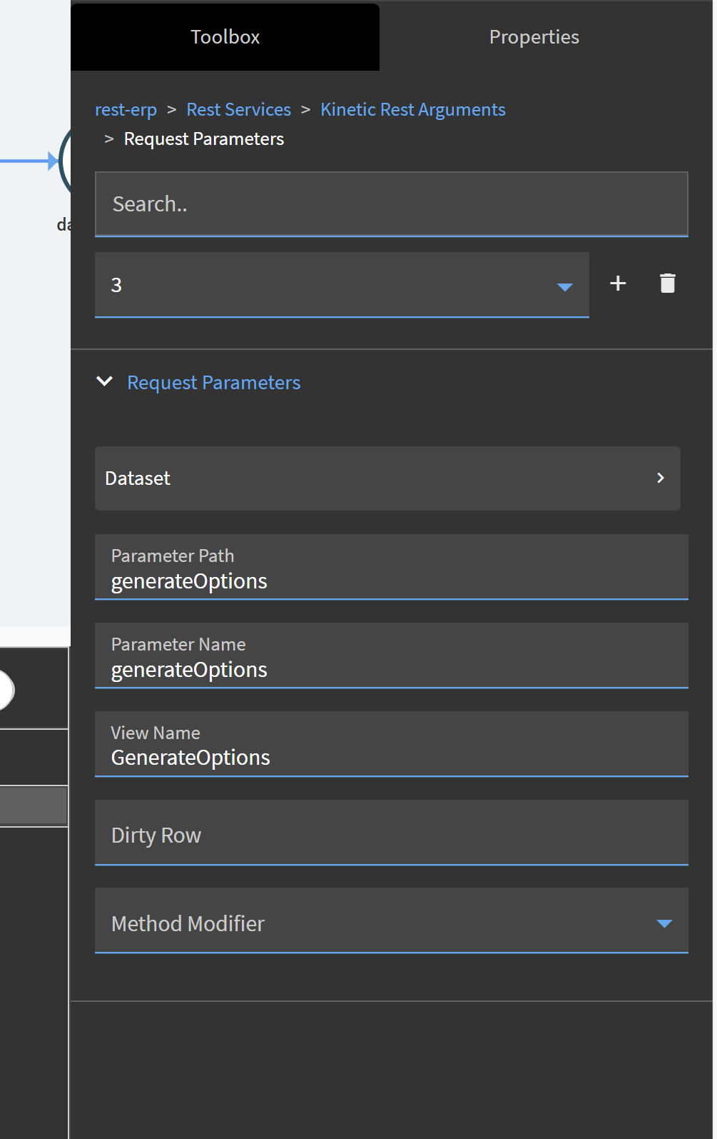

So, I assume I need to use another option here, maybe a dataset. But how can I pass a dataset in the following structure?
generateOptions: [{“BuyerId”: “Some Buyer”}]

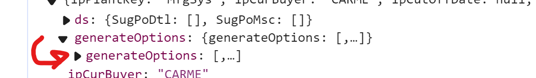

The closest I’ve gotten so far is this:
With the following setup:
This is from the POSugg_Generate upgraded event in the PO suggestions form. I suppose everyone encountered the same issue, didn’t they?
