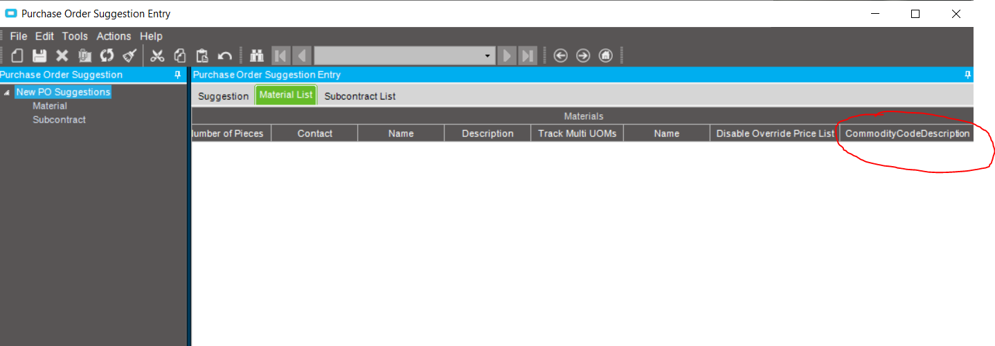

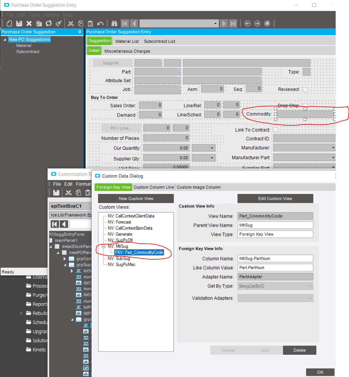

So far I have brought in the Commodity Code Description field as shown in the screen shot 1 to the main Detail tab. This works easily enough like any other FKV. Sadly adding the FKV does not also add it to the system data view for the Material List and Subcontract List tabs.
I found an article on another site which walked me through how to add new fields to the list as the other screen shots show. The one line of code brings in additional fields to the epiDataView system query and displays them correctly into the bound list (MtlSug).
What I really need help with is getting this new field to populate the right Commodity Code ID/Description values just like my FKV does on the Detail tab. As of now I see no way to do this other than a BPM that pulls in and writes the value to my new added field, but for that I have no idea where to begin.

@geofmcguire Maybe I am just lucky, but I have a ton of fields I added to SugPoDtl and they all appear in the list view of suggestions without me doing anything. I see this in all of my list views that UD fields are added based on the view.
I populate them in post process of POSugg.GetRowsPlant and then the data is part of the suggestion.

@geofmcguire Most data collections are still based on a table or view. I added the fields to SugPoDtl table. Regened the schema and the fields are in the list view. Most of these fields are from 9, but I added one recently and it appeared without any extra work needed.
Thank you both for the feedback. Will do a little testing and post findings. Jose’s statement about a BPM to query and return values one row at a time seems like it would drastically increase loading time for results.
Greg with your suggestion, assuming I can go in and add two new UD fields to the SugPODtl table in the database, regen the schema just like you do with any new fields created, and the fields show up how do you populate the values? In my case, I would be returning the Commodity Code ID/Description fields from Part Entry and populate the UD fields with those values. Would this not also be a BPM get data from table or something similar?
@geofmcguire This thread has the code used post processing bpm on POSugg.GetRowsPlant to lookup the data from Part to fill the fields.
