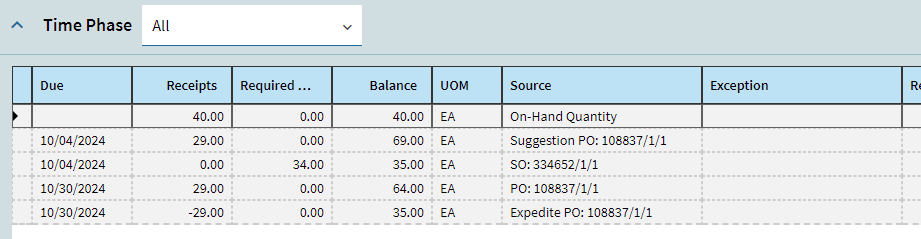

Trying to wrap my head around how new PO suggestions run for safety stock. I have a part that’s set to go below both minimum and safety stock, however the new PO suggestion sets the due date out to the lead time of the part rather than replenishing safety stock.
Once a PO is placed for the lead time, we then get a change suggestion to expedite the PO to cover the safety stock.
Is there a way to get the initial PO suggestion to trigger for the safety stock?

Right, it’s more about the urgent planning. The other odd thing is that the initial PO suggestion is to order at lead time, and then the next time we run suggestions it tells us to expedite the PO we just placed. I’d hope that it would just give us the expedited date in the first place :man_shrugging:

further down the troubleshooting path… if you use a different vendor, does your PO suggestion show the other vendor? If not, then MRP isn’t seeing the Urgent Planning stuff and that should be reported as a bug.
That’s a good idea. Someone seems to be hogging our Pilot bandwidth at the moment but I’ll give it a look when I can get back in again
Suggestions are showing the normal vendor instead of the urgent planning vendor, so it’s ignoring the urgent planning parameters for some reason. I can go the epicare route to see if they can identify the issue
