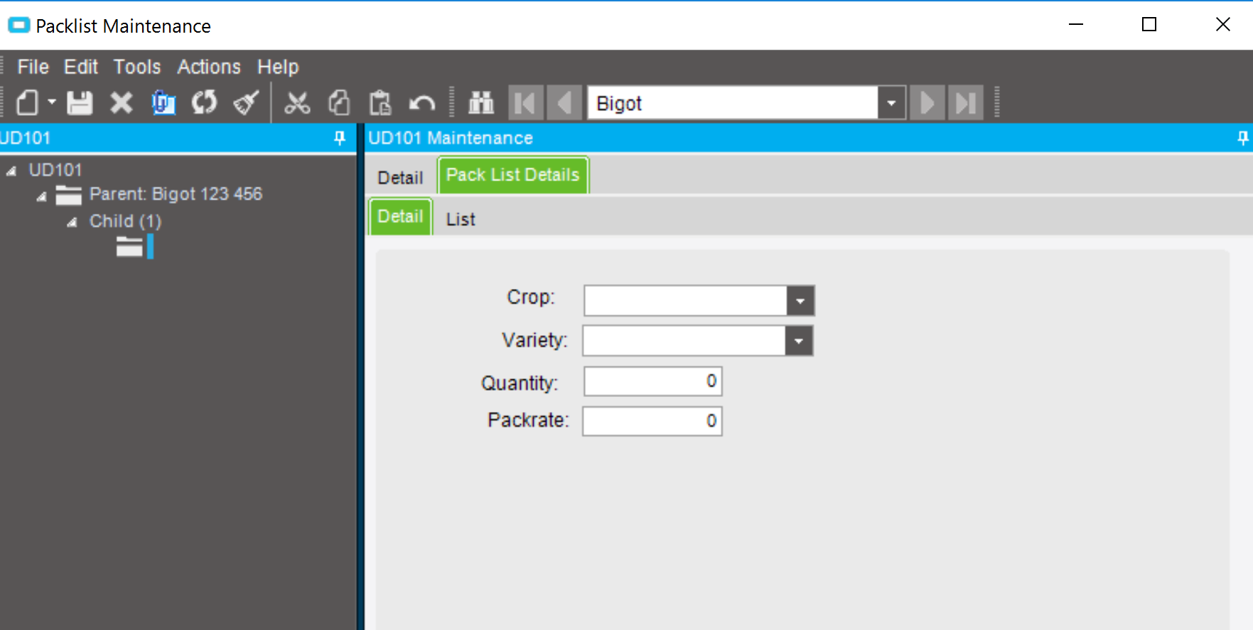

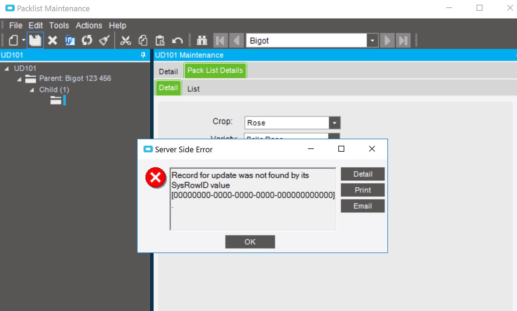

Somebody please help. I can only add one row under child tab. When i try adding a second entry i am gettign below error
You need to auto increment the child record.

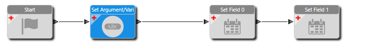

Create a int variable… Mine is called excNum
Drop in a set variable
The expression I use
(Int32)((Db.UD101A
    .Where(r => r.Company == callContextClient.CurrentCompany && r.Key1 == ParentKey1)
    .Select(r => r.Number20)
    .DefaultIfEmpty(0))
    .OrderByDescending(u => u)
    .First())
Set Field 0
(excNum+1).ToString("D3")
D3 just adds three zeros in front e.g 001, 002, 003
Then just increment Number20 in the background
- excNum+1
