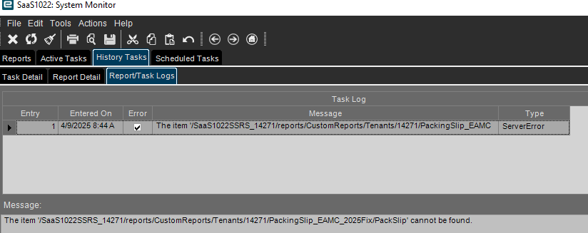

When copying an existing SSRS report and giving it a unique folder path, we get the following error when printing:
We can make a copy of the standard ssrs report and give it a unique file path. This prints successfully. We can also manually recreate our ssrs reports following this method with success but with the volume of custom reports we have this is not an acceptable path forward.

This issue is related to reporting file paths on the server. Some time during the last update, many of our reports did not get the cut-over command:
You can double-check to see if you have similar issues by querying the Ice.CustomReportStoreHistory table.
In our case, support is working on a hotfix, but no date for its arrival yet.

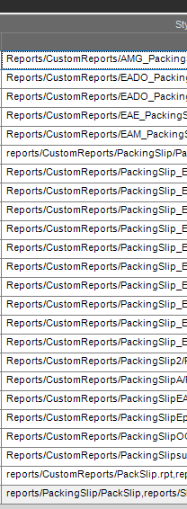

Where would I see the full path for the DB? I see the partials listed in Report Style Maintenance:
I think I see the full path using the CustomReportStoreHistory table, but I don’t think modifying anything there would be useful.

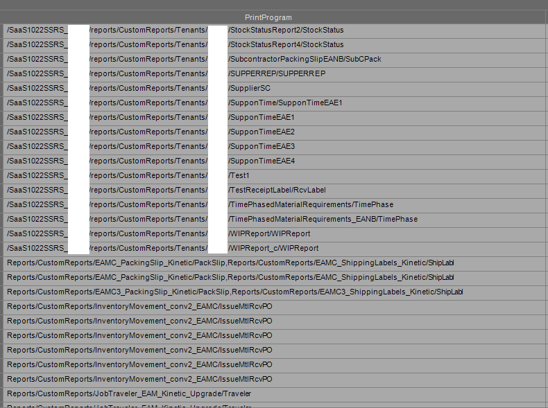

You won’t see a full path, just a relative one.
Which ones are incorrect?
That I do not know. In the phone call with Epicor the tech said they didn’t know which path was right either. I’m still waiting to hear back on that.
The paths that have been causing me the most trouble with the “Cannot be found” issue were the ones that start with “SaaS”. But after looking at our system, I have job travelers that use that path and work just fine, even when copying them. This whole situation gets weirder the more I look at it XD
Copy one of the SaaS ones, but use the new convention.
I bet it works after that.
