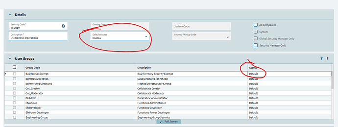

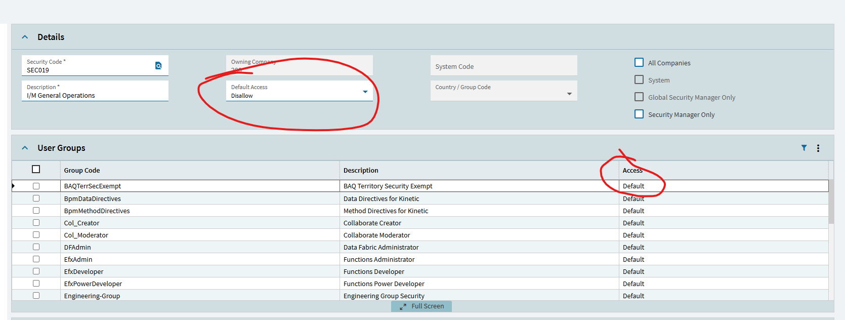

In Menu Security, Choose the Default Access; then,
in the “User Groups,” Choose the access from the dropdown for each group.

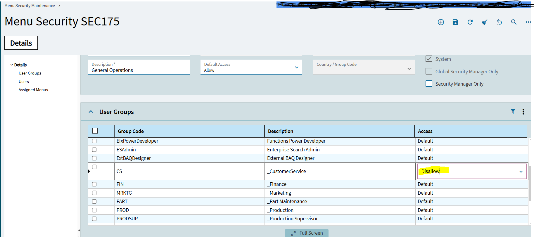

Should be able to scroll through the groups, find the one you want to change, click in the field labeled “Access”, make the change via dropdown and click save. Here’s an example…
EDIT - and follow what @josephp said
