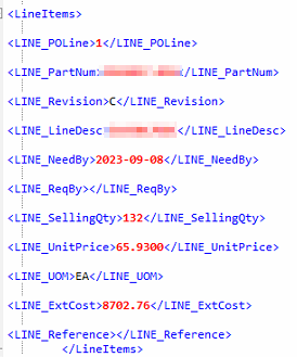

What I’m trying to do is to set up IDC to export the XML data of the header and lines of AP invoices. I’ve been able to get the XML out of IDC, and applied an XSL transormation to get the XML out that seems to be working. I can match this up to the header information in EDC when I bring it in to my document type.
This is the output of the XML, header information all has it’s own tags, and the Lines_Table has it’s own tags for each line.

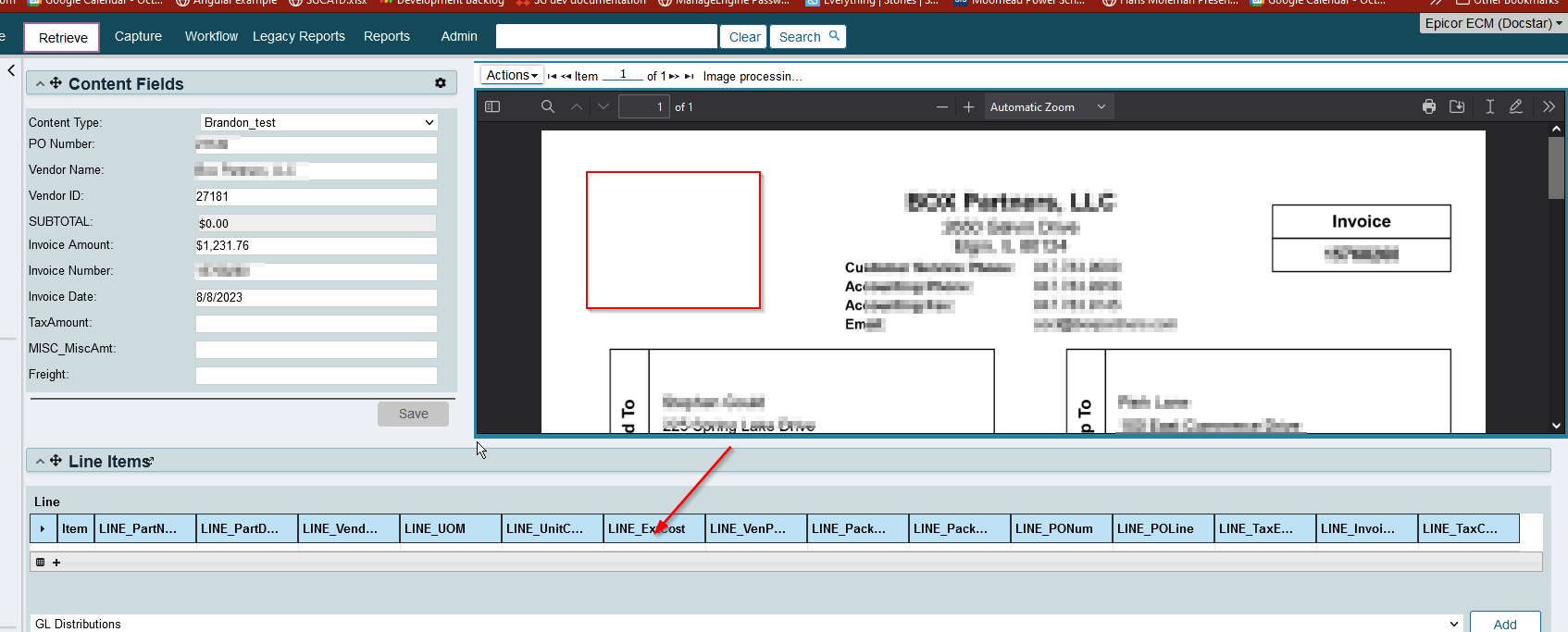

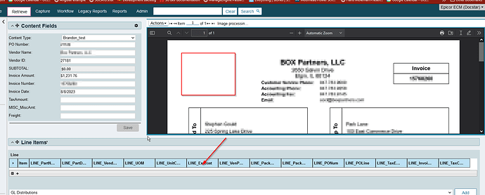

So what I’m missing is, how do I relate this sub-table of lines into EDC. I see in my document information, there is grid for line items, but I can’t figure out how to tell ECM to get the line info from the XML and populate line information on it.
Is my XML a wrong format to do that? (I just took @MikeGross s transform and it seemed to “work”). Or is there something that I’m supposed to be able to do be able to map those fields?
I did play with the xpath and I can get ECM to display those fields, but when I try to map them to anything, they don’t seem to do anything.

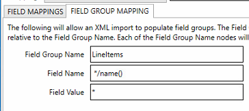

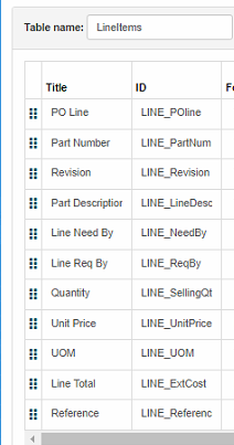

@Banderson I think it is just a mismatch on the field table grouping. Looking at your screenshot you have Items in front of all of the LINE_ fields, but you have Lines_Table in the file.
This is from SOA, but the same applies. Table name from the DFD, field group matching in ECM import and the XML file.
Fields names in DFD must match even upper and lower case the field names in the XML.
