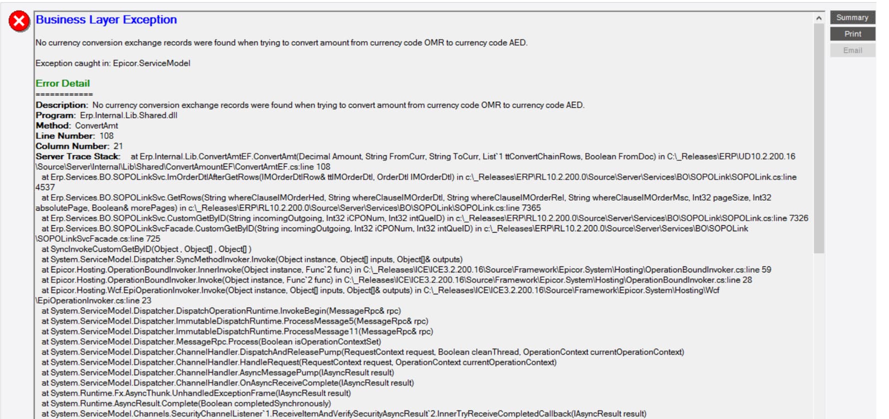

Getting below error in incoming po suggestion screen when trying to accept po from inter company.
Exchange rates defined in both companies.
Checked inter company customer /supplier setup in both company.
Receiving company reporting /base currency is AED and sending company currency is OMR. Please suggest

working for other intercompanies but currency is same for receiving and sending .Issue with different currency sending company. Do i need to set currencies as global?

Currency rates are built using IMOrderHed.OrderDate, IMOrderHed.RateGrpCode and the currency from the customer according to IMOrderHed.CustNum.
Is there is a Customer with number IMOrderHed.CustNum?
Does the rate group IMOrderHed.RateGrpCode has rules between the SO currency (OMR) and the base currency (AED) for the IMOrderHed.OrderDate?
Is there is a Customer with number IMOrderHed.CustNum? Yes intercompany customer
Does the rate group IMOrderHed.RateGrpCode has rules between the SO currency (OMR) and the base currency (AED) for the IMOrderHed.OrderDate? Yes rules are there for IMOrderHed.rategroupcode(sending company rategroup) .Effective date is before order date.
