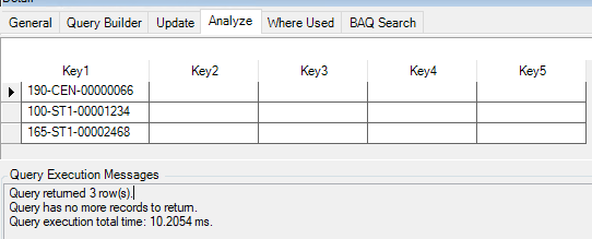

Let’s see a baq of that table with all 5 key fields visible.
I get no errors with your exact code.
I built a BAQ and returned the expected data. I’m wondering if there is a permission issue on the account to access the BO.
select
	[UD12].[Key1] as [UD12_Key1],
	[UD12].[Key2] as [UD12_Key2],
	[UD12].[Key3] as [UD12_Key3],
	[UD12].[Key4] as [UD12_Key4],
	[UD12].[Key5] as [UD12_Key5]
from Ice.UD12 as UD12
where (UD12.Key1 like '%')
