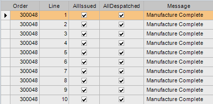

Hi @Hari_Dutt ,
Here is the output from the BAQ;
