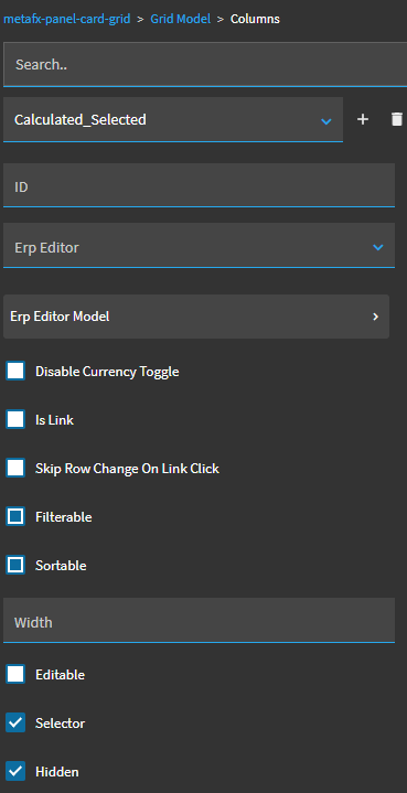

To facilitate this selection functionality, I added a Calculated_Selector column to the BAQ, which serves as the selector field in the grid. This enables me to identify the currently selected record within the DataView condition widget.

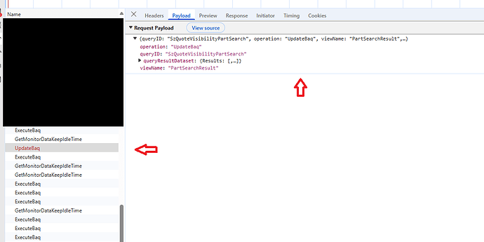

The setup works well, allowing users to search for and select part numbers. However, a problem occurs when users select a record and quickly scroll through the grid; this action triggers the dashboard to call UpdateBAQ during the scrolling process.
I should note that when a record is selected in the grid, the RowStatus column is added to the DataView, and the record is marked with a ā€˜U’ symbol. This behaviour is similar to that of an updatable Dashboard, but since the BAQ itself is non-updatable, I do not understand why it would call UpdateBAQ at all.

Using Selector functionality provided by the Epicor Kinetic Grid.
The Selection is purely UI based, I do not intend to log changes to the DB. The Calculated_Selected column was added for two reasons:
  1. Make use of the Grid build in pagination functionality.
  2. Be able to access the Calculated_Selected column from the Dataview for the purpose of determining which column is currently selected.

This BAQ is not updatable hence no BO method to call, but UpdateBAQ call returns an error that causes an ugly error slider to appear during grid scroll, and even worst, is that grid remains broken afterwards and does not load data, user needs to refresh application for it to work again.

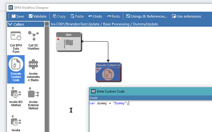

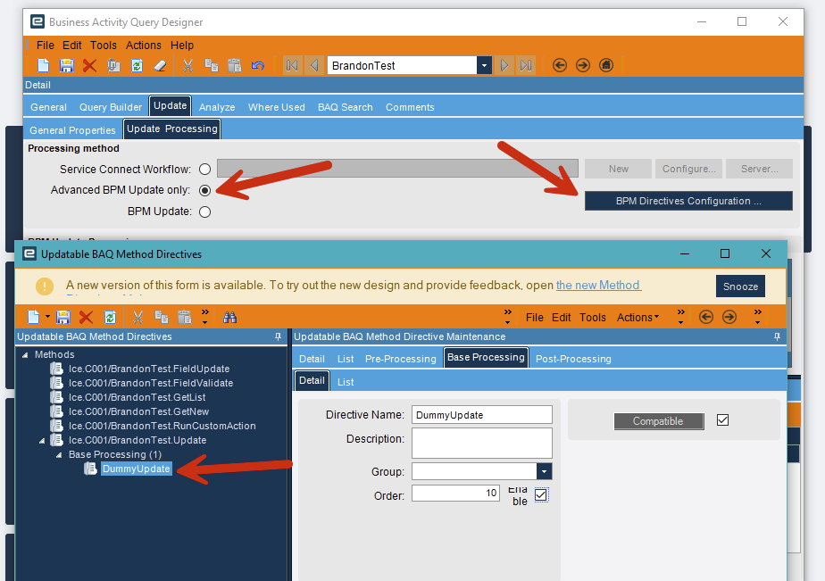

So what I would try, is make your BAQ updateable, then set the processing method to Advanced BPM Update Only. The open the BPM directives.
Then make it do something… It’s pointless, but I’ve had to do that to get rid of the errors in other places.
See if that stops the yelling.
