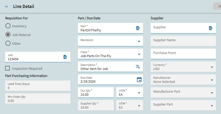

Check out Requisition Entry. You can create a req for a part and link it to a job.
Once approved this will add the part to job and create a buy direct PO suggestion.
Hi Zack, thanks for your message. For Parts, we use the Issue material to jobs and find that working fine, but more for PUR-UKNs that we do for jobs. What would be a way that we can purchase ‘other’ to jobs? thanks!
Requisition Entry will allow you to enter non part master part
You will need to have at least one part class setup that allows Requisitions
What @zwilli526 says, use Requisition Entry
