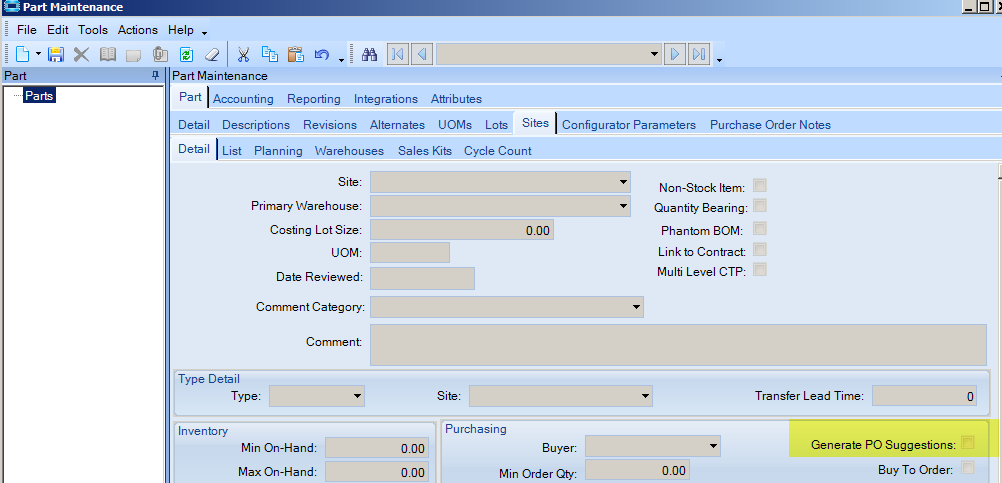

This sounds like something we could use, what happens about the raw materials that are required on these jobs? Do you get purchase suggestions if there is no stock? Or do you have manually check each job?

We don’t use MRP, and PO suggestions are created. (Assuming you run the process to create the suggestions)

Hi John,
Yes, you will get PO suggestion for the materials if: you created a job from the new planning suggestion, you placed or pulled method details to have the materials on the job, you schedule the job (must be firm too, naturally is this from changing a suggestion into a job), the job materials are setup as purchased type in part master and have generate suggestions checked on the plant tab.
