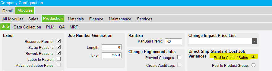

We do have a similar setup. When the job is closed, it will create MFG-VAR transaction, which will post to COS. Check Direct Ship Standard Cost Job Variances as Post to Cost of Sales in Company Configuration.
Wowwwwww… I always just modified the product groups. Never knew that.
