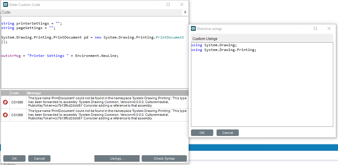

I am trying to print the Customer Shipment Entry Report to the Windows Default Printer in the BPM or function. I am not able find the Default Printer Name or Page Settings in the function.
System.Drawing.Printing.PrintDocument pd = new System.Drawing.Printing.PrintDocument();
Above code throws an error
Did anyone successfully find the windows default printer name in function or BPM?

The delimma trying to use the default printer from a BPM or a function is that will be in the context of the server, so that will never work.
So it’s widget, or using the workstation to determine the Printer defined for the specifically logged in user.

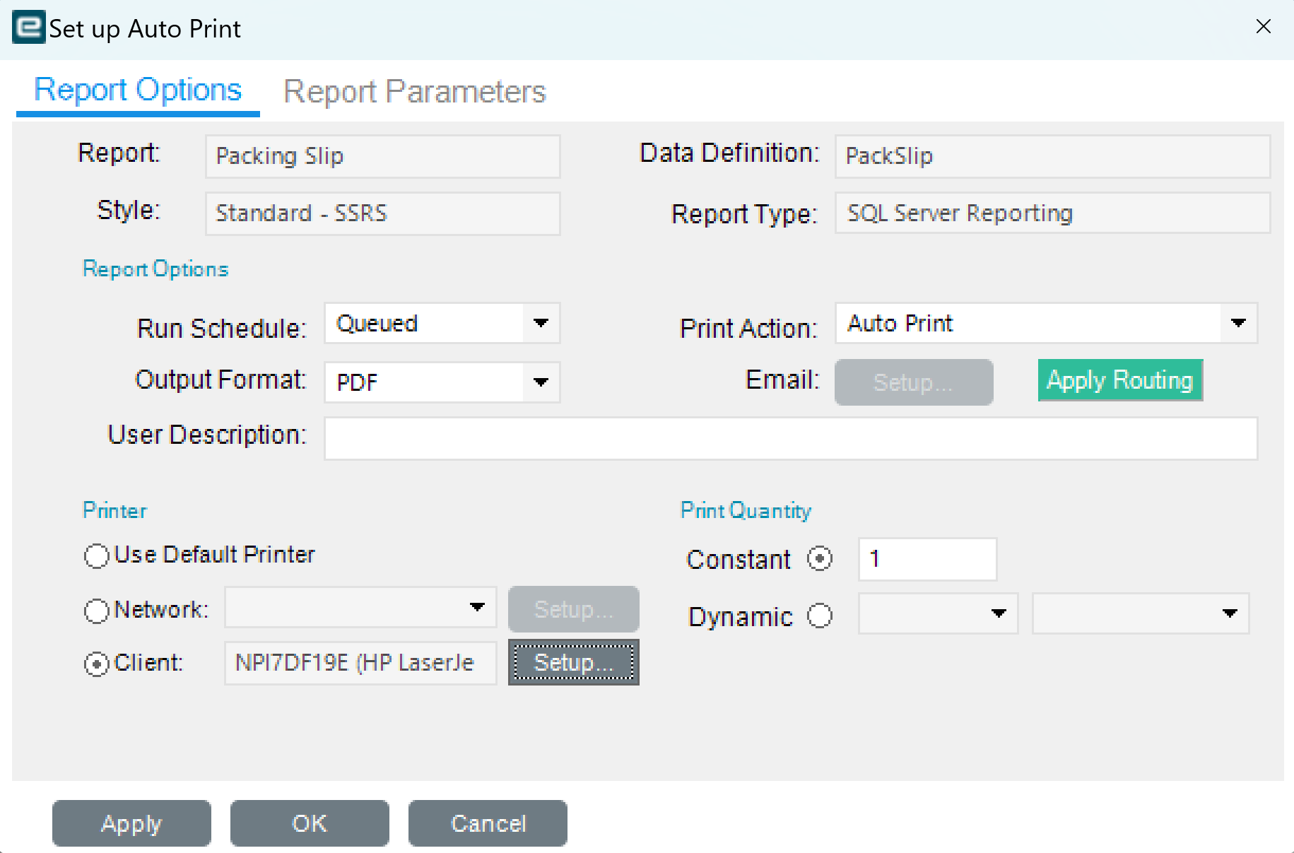

Using no customisations, if using counter sales from the sales order depending on the settings of the pack and invoice it will automatically load the pack and invoice print screens. The user can click the print button (which defaults to the client print option) and it will automatically select the default printer.
Typically for auto printing the autoprintready flag is the field is used with a condition that can be used to trigger the autoprint from the standard data directive. So provided the field is exposed on the form (and by default on Customer Shipment Entry it is not), and the user has a configured workstation applied to their session (either by defaulting in their user account or selecting a workstation when they login), the auto print data directive will print to the correct printer. So very little customisation need if at all. Just configuration and training.

Might not work in a function but it does work in a BPM. You can access the local printers on a client from a BPM. Assuming that we are not talking cloud anyway.
It’s no where near an great way to do things, but it will work in a pinch.
If the printers are/can be networked, that’s the best solution by far.
Just so no one is confused, in this context he means local “network” printers. Not local like connected via usb or something.
If you are using the smart client (even in the cloud) you can do it, but it’s not a great option. I have one scenario currently using this for a USB label printer, but it’s such a bad choice, you even get a popup message telling you so when you choose it. The other caveat is that it will only print if the user has Epicor open since it is delivered via the client.
