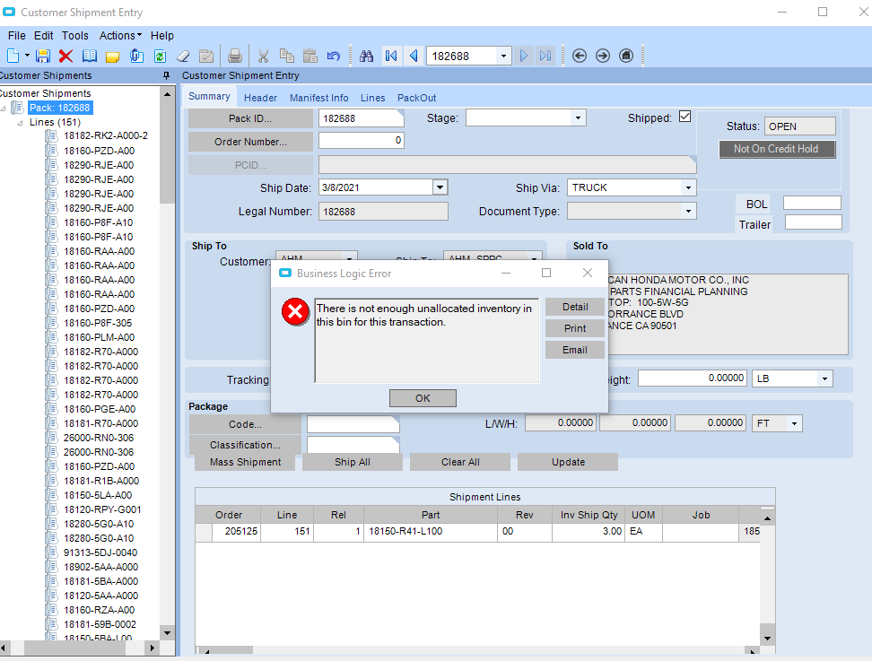

Not enough unallocated inventory in this bin for this transaction?
Hello I am gettin this error when trying to ship a customer shipment entry
is there a way I can debug this and see which part it is talking about?

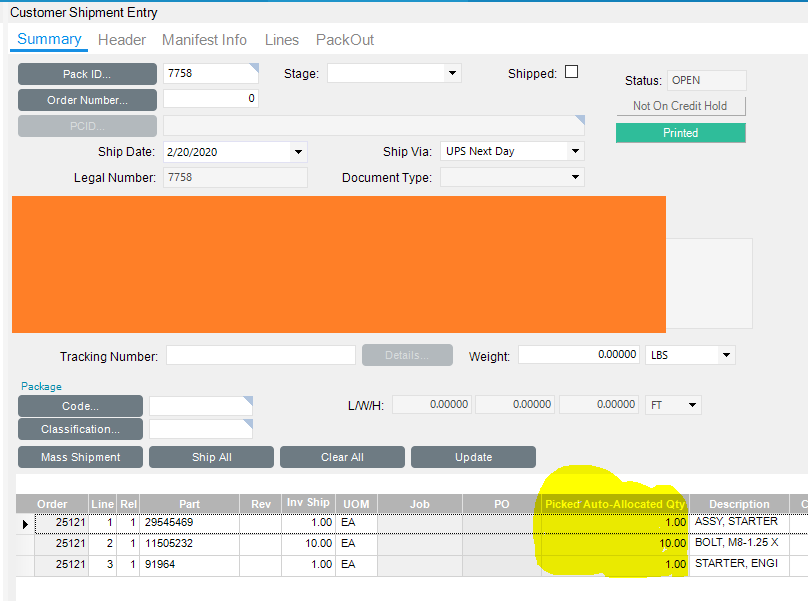

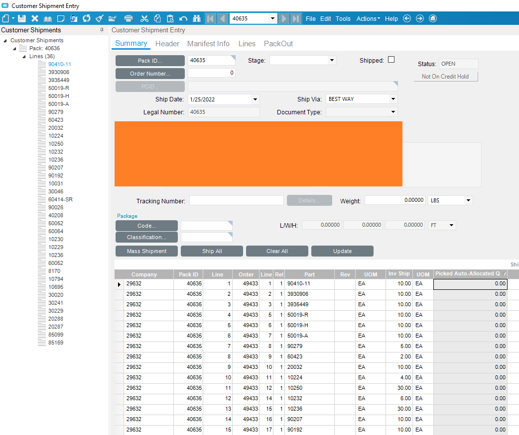

I had thought this column had the key to the puzzle (from my notes two years ago)…
…but I tried today and it’s all zeroes (and line 31 does have an allocation of 4 EA that I need to know about):

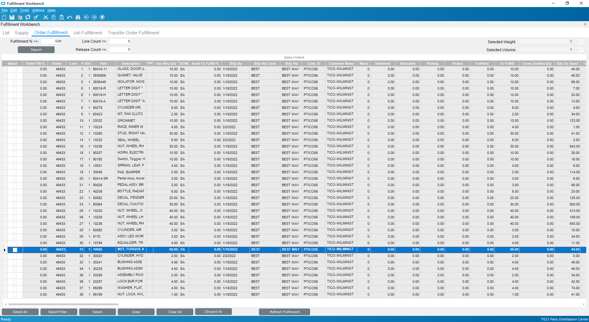

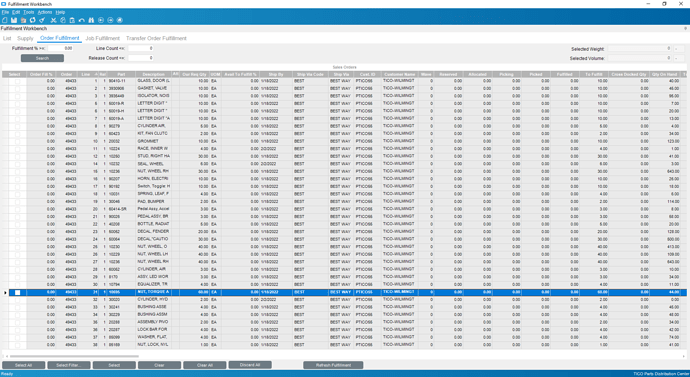

If you look at this particular order in Fulfilment Workbench does it give some insights.
So, to be clear, I don’t need a solution to today’s problem. We figured it out today and that’s in the past now. I just want to know how people avoid this on a regular basis. What are we systemically doing wrong? (Yes, not having enough unallocated inventory in the bin, I know, ha ha.)
@Vinaykamboj Not so much on FWB. I don’t see the primary bin on FWB, so how could you ever figure which part/line was the problem in the shipment? (FYI the culprit is part 10695 in bin S30CD - I know because this is a test scenario.)
