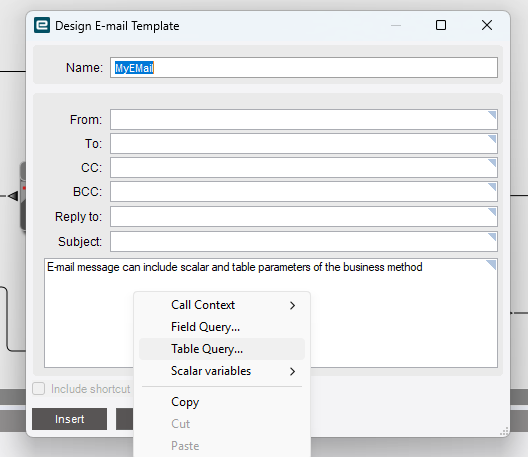

Hello,
I am trying to teach myself Epicor Functions but it has been a slog.
I am watching the youtube ‘Epicor Functions’ from Codabear and having issues reprodcuing their example. (https://www.youtube.com/watch?v=2bKcOnBUA1U&t=1892s )

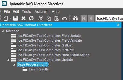

I get to the part where I create a new base processing called EmailResults.
I do the design and add the email widget.
I click in the body of the email and click ‘Insert’.
Below is all I see.
Why do I not have access to the Part table?
Is there a setting or a step I missed?
Any help is appreciated.

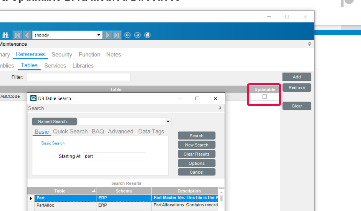

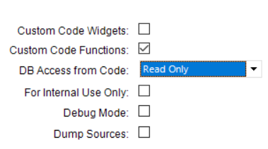

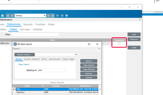

You need to go to “References” on the library, and add the table.
You also need to make sure on the main Library screen to allow access to the db. (if doing code)
If you need to write to the part table (with the DB context), you’ll need to select the checkbox on the table in the references tab.

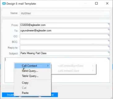

In the youtube video, he creates a uBAQ to email parts that are missing the ClassID. The part I am talking about start at approx 29:06 into the video.
He created the BAQ
Added Part table
Added a few display fields
Sets BAQ as Updatable
He then went to Update tab and selected Advanced BPM Update Only.
Then he clicks the ‘BPM Directives Configuration’ button.
Selects the Update method on the left and adds new Base Process.
Click the ‘Design’ button and add email widget.
At this point is where I don’t see the table query like he has (His screenshot below) at 32:02.
I didn’t see any steps I missed.
I am a Gov Cloud customer, if that makes a difference.

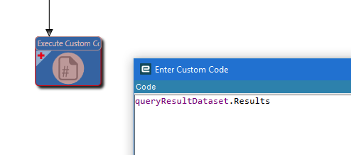

We are on premise. I believe it would be with the change they made to the objects for the results. You have to use queryResultDataset.Results. It used to be on the top level of that object. You can get this using some variables, but it’s not as easy as it used to be. I was looking for an object type to use a variable to assign the results to, but I couldn’t find anything.

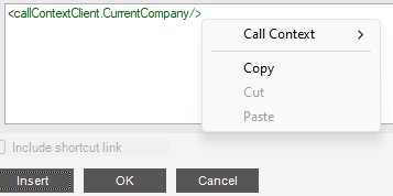

What options are you seeing when you right click in the mail message? In a blank one vs the one with the callcontext
shobdy
(Shawn Hobdy)
April 22, 2025, 1:00pm
19
I have been playing and created some variables so now I see those.
Otherwise it is the same as above.
