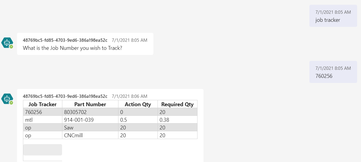

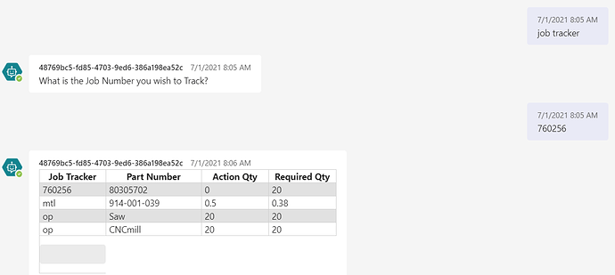

It is kind of convoluted with MS low/no code integrations, but I used something called Power Virtual Agent to create the bot in teams, and that interfaced with a Microsoft Flow program that did the REST connection, and put the json into an html table.
I spent too many hours messing with adaptive cards with this, and it ended up not really working due to adaptive cards not being fully supported in teams.
