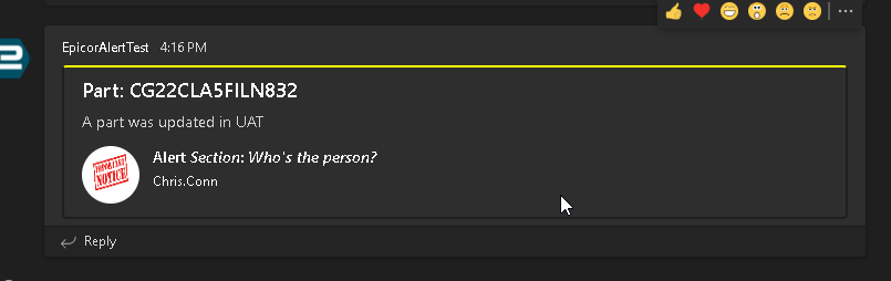

Notifications to MS Teams
Perhaps I am late to the ball game, but I just implemented a solution to send alerts from Epicor to Teams (as opposed to email). Gamechanger.
GIST:
The article speaks to PS but I just used REST.
I vote for @hkeric.wci to do a proper Linked In article on it.

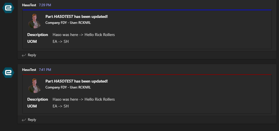

Moving from email (point-to-point communication) to a group notification is a huge improvement. The game changer? Actionable notifications:
https://adaptivecards.io/samples/ExpenseReport.html
Notice how Theme changes color @ERPSysAdmin
Quick Dirty Example
// Add NewtonSoft and RestSharp Assemblies
Action < ResponseStatus, string, string > notifyTeams = (status, message, title) => {
  var client = new RestClient("https://yourco.webhook.office.com/webhookb2/b62d6918-1152-47d6-9276-780e37d4a21a@99182fcd-14a7-436d-921a-2013548939cd/IncomingWebhook/8bbfe7bc4c54a54bfe8d1cd9f7805a6/2-ea25-40bb-a7f1-f15e55c94a87");
  int responseStatusCodeTeams = 0;
  string themeColor = "0072C6";
  if (status == ResponseStatus.Completed) {
    themeColor = "0008FF";
  } else if (status == ResponseStatus.Error) {
    themeColor = "8B0000";
  var data = new {
    context = "https://schema.org/extensions",
      type = "MessageCard",
      summary = "Incoming Alert Message!",
      themeColor = themeColor,
      // title = title,
      //text = message,
      markdown = true,
      sections = new [] {
        new {
          activityTitle = "Part *HASOTEST* has been updated!",
            activitySubtitle = $ "Company {Session.CompanyID} - User: RCKNRL",
            activityImage = "https://www.pngmart.com/files/11/Rickrolling-PNG-Transparent-Image.png",
            facts = new [] {
              new {
                name = "Description", value = "Haso was here -> Hello Rick Rollers"
              new {
                name = "UOM", value = "EA -> SH"
  var content = JsonConvert.SerializeObject(data);
  //Begin Create REST Request
  var request = new RestRequest(Method.POST);
  request.AddHeader("Accept", "application/json");
  request.AddJsonBody(content);
  var response = client.Execute(request);
  responseStatusCodeTeams = (int) response.StatusCode;
  //End Execute REST Request
notifyTeams(ResponseStatus.Error, "Haso has updated ABCCode", Session.CompanyName);
