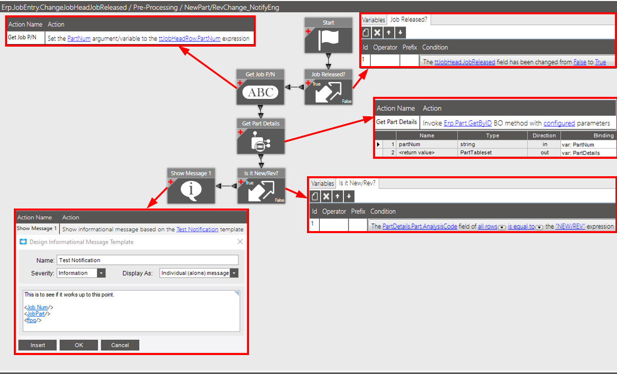

Question 1.) Would I still want to create it on the JobEntry Method such as JobEntry.ChangeJobHeadJobReleased?
(Right now this is where I have tried to build it)
Question 2.) Would I want a Pre-Process that checks that the Job Release is True and sends the email, then have a Post-Process that sets the Part.Analysis Code back to blank?
(I have tried putting it all on Pre -Process and had no luck. Then I tried to split it up to have the Check/Email on the pre with the Field setting on the post and I still cannot seem to get it to update the Part.Analysis code to blank.)

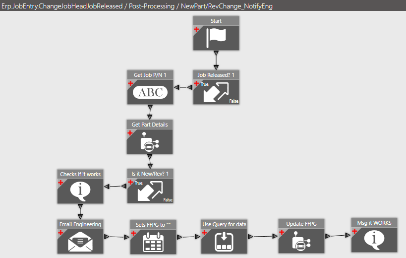

Here is the second attempted I tried:
*Which does produce the Message, but I cannot figure out how to Changing the Part.Analysis code to blank.

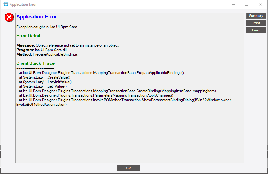

Here is the Error it gives me.
What I did:
1.) I place the Invoke BO Method
2.) Select to invoke Erp.Part.GetByID
3.) Set the configured parameters I set to PartNum in Va.PartNum and out to PartDetails
4.) Select ok
5.) I get this ErrorâŚ

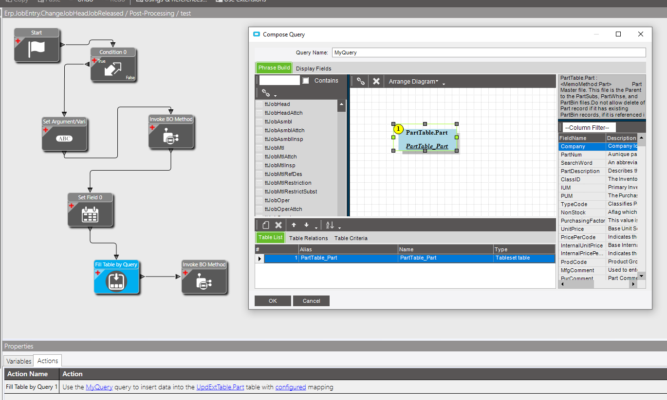

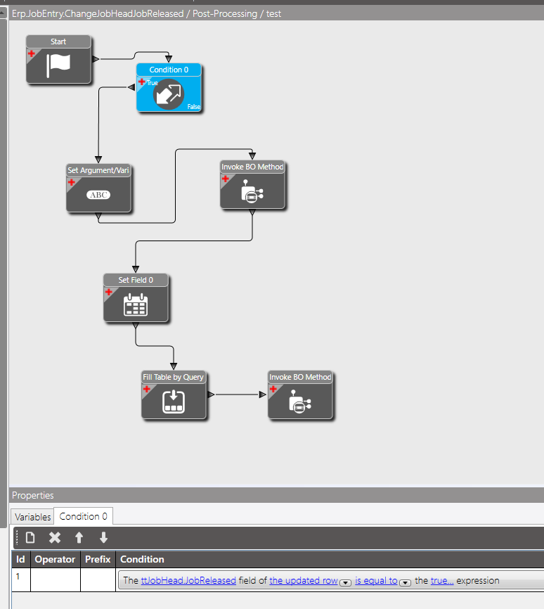

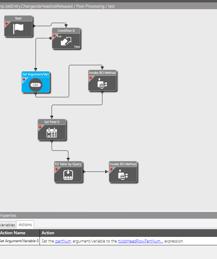

Hereâs something I set up that JUST updates a field on the part table when a job is released (I didnât have analysis codes set up, so I just updated a UDChar field):

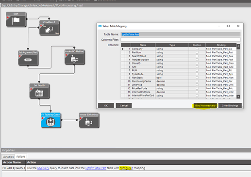

The ds parameter for the UpdateExt is a UpdExtPartTableset type variable, so the PartTableset that is returned by the GetByID method wonât work. Instead, I made a new UpdExtPartTableset variable that I fill with the PartTableset.Part in the âFill Table by Queryâ widget:
I think you just need the key fields here, but I went ahead and brought everything over (including the updated UDChar field)
This updated the Part.UDChar01 field to âNEWCODEâ for a jobâs part when the job is released. I used UpdateExt because I couldnât get Update to work.

Good deal! Now that I think about it, the BPM probably doesnât need the GetByID widget. Could have filled the UpdateExtTableset just with the standard part table (then update your field), and pass that to the UpdateExt widget. But either way, glad you got it working!
