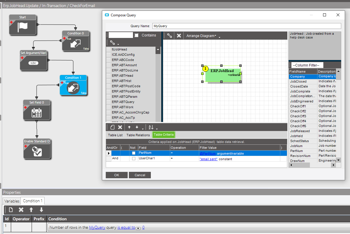

That means you’d need to have a query in your BPM that looks at the JobHead table to see if that part number has been on a job before. If you have a LOT of jobs (hundreds of thousands or more), that query might take some time to run. THAT may impact what Method it could be used on, or if it would run efficiently on a Data Directive at all.

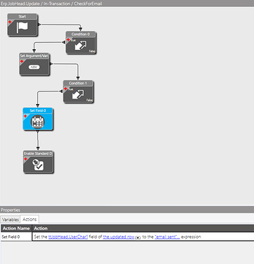

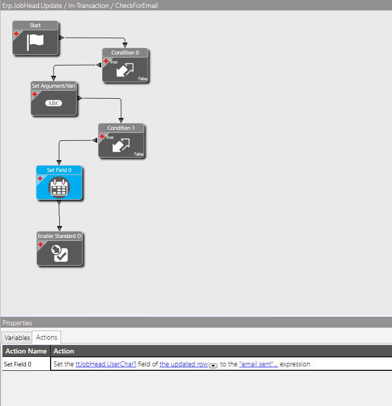

There should be pre-made UD fields on the JobHead table (UserChar1 etc.) that you could use to record when a job was initially released and the email is sent. Then, once the email is sent, you can update one of these UD fields to “email sent” or something, and use that field to filter out jobs that are re-released so they don’t send out additional emails.

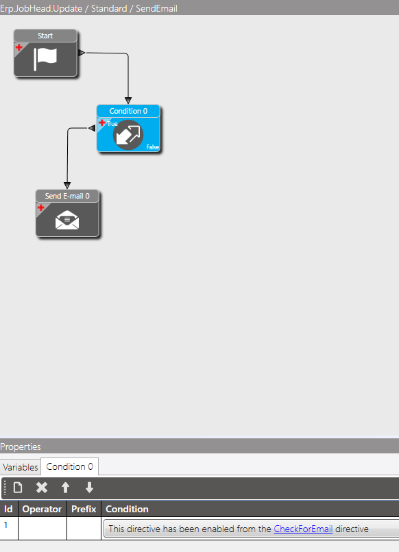

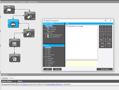

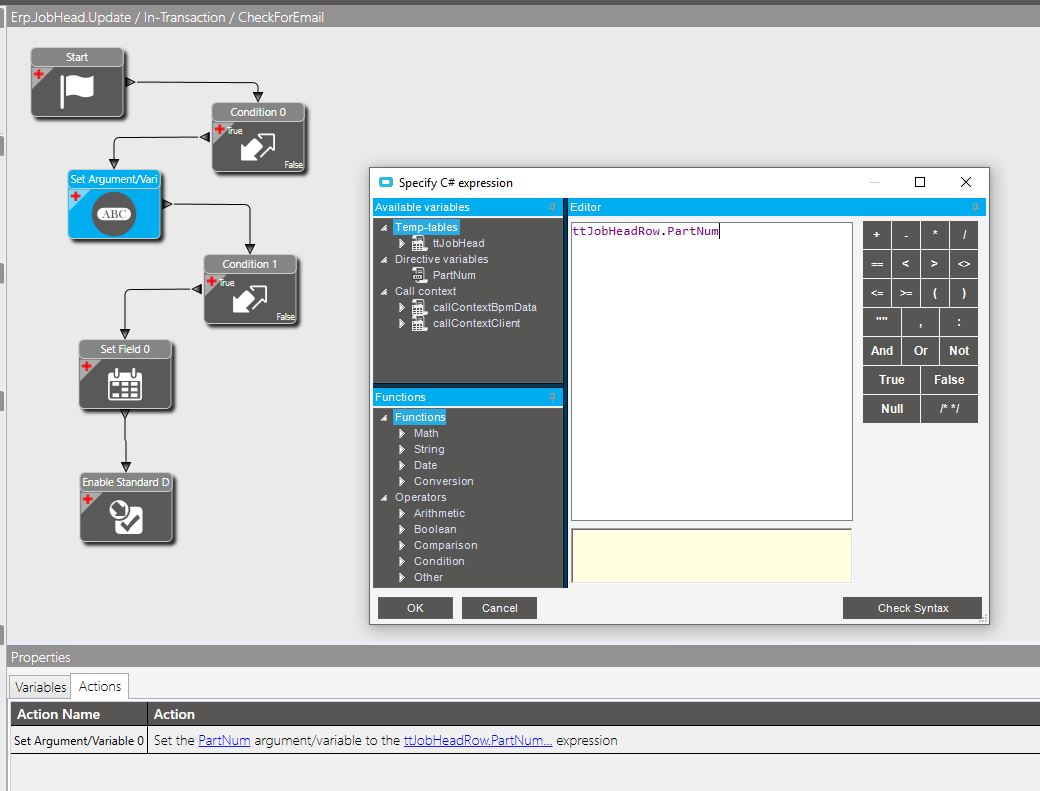

I made an outline of a data directive on the JobHead table to help as an example. It’s 2 parts, 1 in-trans directive to check for the conditions and update the UD field if they’re met, and one standard to send the email that’s enabled by the in-trans:
It doesn’t account for the job being for a top level part. Also the query table joins could be made more efficient by not joining the temp table to the job head table, and filtering using variables instead (Edit: updated to reflect this).

Might be a silly question, but in the image where you show the query…would that be considered joining to a TTtable? Being I am using the TTJobhead to get the part number, would using the ERP.JobHead in the query be considered ‘joining’ them? Or does that only apply when they are actually joined in the query itself?
