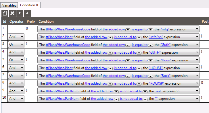

To be clear, the whole condition is:
((whse == ‘mfg’ AND plant ‘!= MfgSys’)
OR (whse == ‘Guth’ AND plant != ‘GUTH’)
OR(whse == ‘Hous’ AND plant != ‘HOUST’)
OR(whse == ‘Rock’ AND plant != ‘ROCKSP’))
When that is true send me an email
But emails were being sent out with empty values for PartNum, Plant, And WarehouseCode
So I decided to add a check for blank PartNum, by adding
AND (PartNum != null AND PartNum != ‘’)

I doesn’t seem like empty or null should make it through that anyways even without the added condition

But I occasionally get ones with all blank values. Here’s the body of the email
Plant:
Whse: /
PartNum:
DateTime: 12/11/2018 5:05:35 PM
When it should be like:
Plant: HOUST
Whse: Hous
PartNum: CB-0006DateTime: 11/26/2018 9:45:26 AM
from the following email template:
I traced the that date time back to a new part being created, but that didn’t create the bad record I’m monitoring for.

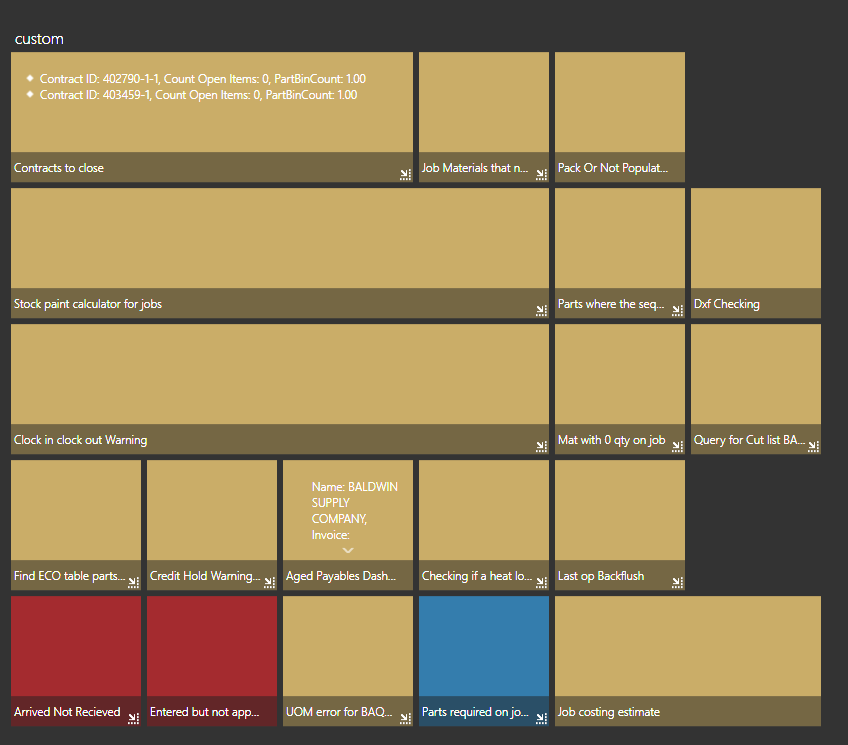

For things like that, I like using BAQ gadgets. Anything you can find in a BAQ you can throw on your home screen. Then then these can be run at certain time schedules. When something shows up, it means I should go check it out. I like that a lot better than e-mails.
The emails were also sent to the purchasing folks, so they would know to be skeptical of the QOH of a flagged part. At least until I got to run the data-fix.
I guess I could make a BAQ Report and schedule it to email daily. If no records exist, than no email goes out…
But that doesn’t answer the question as to why the DD triggers, but the resulting email has blanks for the field values.

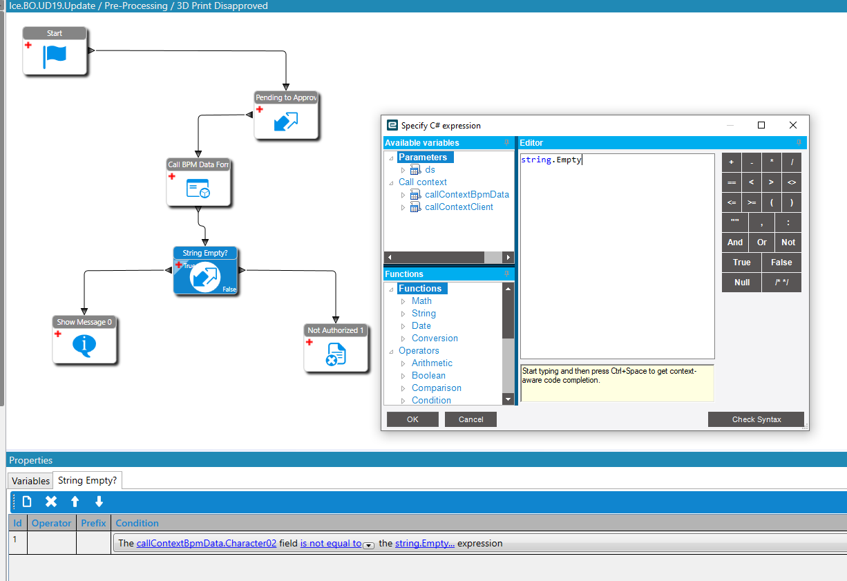

A bit of a shot in the dark here, but have you tried using String.Empty instead of “”?
You could also do a custom code condition and check the length of the PartNum string. Although if you’re doing that you may as well just use the String.IsNullOrEmpty and/or String.IsNullOrWhiteSpace methods.
And when you’re on vacation, others can see the messages. However, I have no problem with an email (or text or IM) that says, “Check the Sysadmin Dashboard. You’ve got issues…”
I just beat my head against the wall for a different BPM. I ended up just comparing the subject field to another blank field that we never use. If they are equal then the BPM fails.
