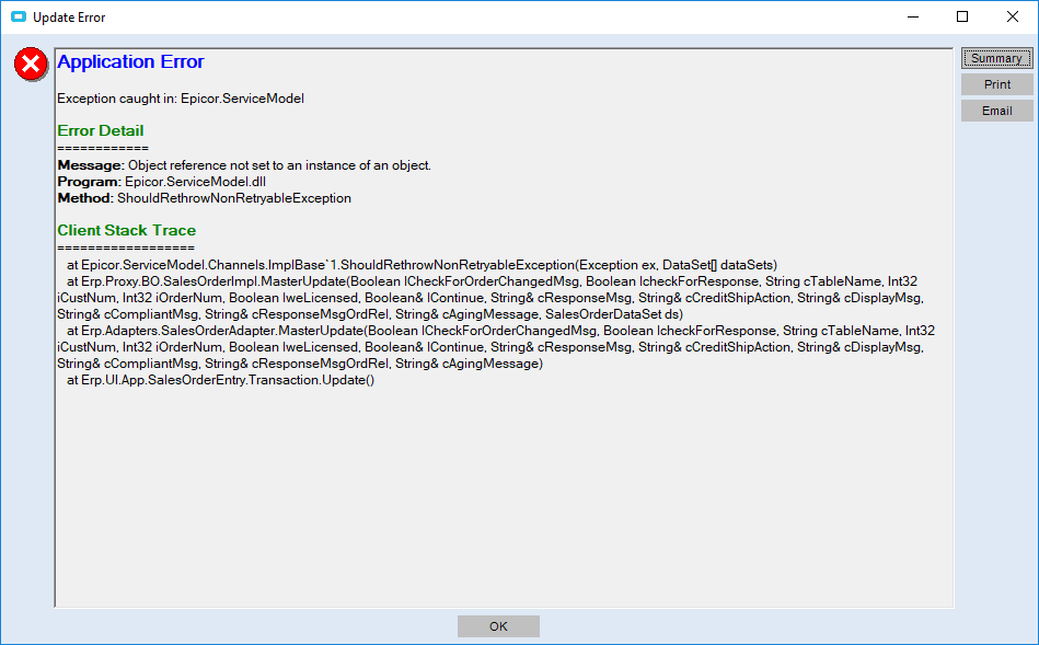

We updated our Epicor 10 installation to version 10.2.300.12 a couple of weeks ago, and our CSRs are occasionally encountering errors like this in the Order Entry screen:

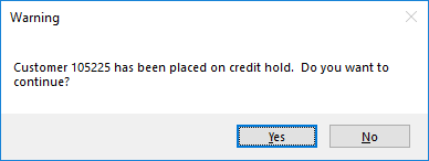

I was able to reproduce it on my test system by opening an order and adding an order header miscellaneous charge with a zero amount. If the order is on credit hold, I get a prompt like this:
If I answer yes, I get the error listed above.
I tried disabling all the method directives on the SalesOrder.Update and SalesOrder.MasterUpdate methods, I also ran the base order form to rule out any customization behaviors, but I still get this error.
