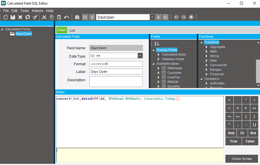

Trying to calculate the number of days since an RMA was created.
I know this is not a “New Topic” but I’ve read several posts where the solution is to use
“datediff(dd, RMAHead.RMADate, Constants.Today).” When I do I get “Operand data type date is invalid for subtract operator.”
IF the “data type” the error is referring to is the “Data Type” in the “Calculated Fields” pane above the Editor then I have that set to integer so I’m stuck.
Thanks as always,
Todd

I read that also.
Tried these:
convert(int,datediff(dd, RMAHead.RMADate, Constants.Today))
convert(int,(datediff(dd, RMAHead.RMADate, Constants.Today)))
Still get same error.

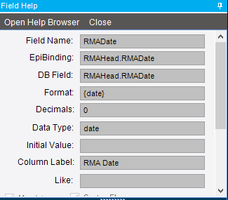

RMA Data Type set to “date.”

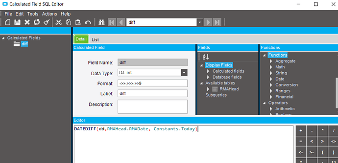

This seems to work perfectly fine on my end.

That formula “datediff(dd, RMAHead.RMADate, Constants.Today)” is perfectly valid.
Your error is somewhere else in your BAQ. Check syntax will show you errors from anywhere in the BAQ.
