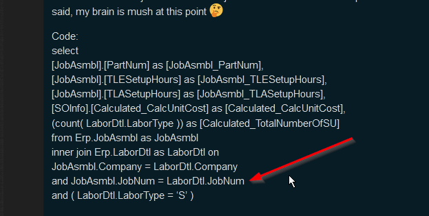

So before you group it, show the job number, and assembly seq, and look at how many rows that you get back.
You can have more than one assembly with the same part number on the job, so if you have 25 jobs, and 10 of them have the part in there twice, you are going to get 35 rows back.
You can also have more than one labor dtl per assembly and operation, so keep that in mind as well.
You can do count(distinct JobAsm.JobNum) and that will count the number of different job numbers that come back with your assemblies.
Always think about your tables and what kind of information is in those tables. Can you have more than one row with the same information? If if you think the results are off, run a test query without the aggregates for a test case and see where the “duplicates” are.
Thank you for the information, I will try this first thing in the morning. You definitely gave me some information to think upon! :slight_smile:
You also don’t have a link to the assembly seq on here. Just joining Job Num and Company is going to give you all kinds of duplicate rows. A labor detail is a job number, assembly seq and operation seq. So you need to join on asm seq as well. And even then, you can have multiples of labor dtl on a single operation.
JobAsmbl will have a record for each assembly within every job.
LaborDtl will have a record for each clock-in on a job.
Count(Distinct) is a blunt instrument for de-duping, but really you should be structuring your query in a way that avoids the duplicates in the first place. E.g. If you’re solely interested in the final product of a job, look at JobHead rather than its child tables.

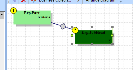

Alternate Method.
Add the Job Head Table to the BAQ and like to the Part table.
Company, PartNum
Make is a summary table. Create a calculated field to count(job head records).
This worked, I finally received the correct Job Count!

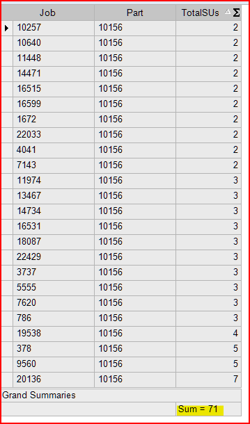

I’ve done as you suggested by taking the subqueries and running them individually - which did show me some errors and so I fixed them.
But…When I’m trying to get the Total Count of Setups I’m getting wacky results. The following picture show’s the correct number of setup’s when I list them by Job Number.
But when I try to “Total” the setup’s I get this and remove the Job Number, I get this:
I know this has something to do with my grouping - Also, I have tried Counting “ClockInDate” and this result is from LaborDtl.LaborType. ClockInDate was not giving me the correct number of setup’s.

Can you post screenshots of your BAQ? (I can understand it better from the BAQ)
But from what I can gather from the code, are you grouping on a subquery and then grouping again in the top level of this query? You should only need to group and sum on one level. There should be no reason to group once, then group again. (in this instance). Conversely, you could count on one level and then count again on the next, but why complicate things?
To illustrate this, if you take your first grid of stuff, remove the jobs, then remove all of the duplicate rows (where the rows have the same total) you will notice it matches the second grid.

Not really. Just bring in all of your sub queries together and join on part number.
Once all my subqueries were added to a Top Level, joining by Part Number…Dare I say it is working!!!
